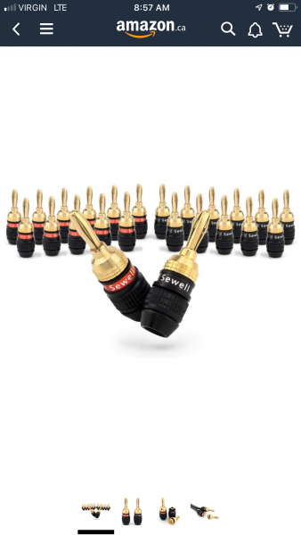

What do you guys think about these banana plugs
You're Canadian. The first banana plugs you showed on post #70 look fine to me.
14AWG speaker wire gauge is fine too, from what I've seen in your previous attachment.
If you need more 12AWG is fine also. With thirteen speakers (if you install them all eventually), you'll need many feet of speaker wires. Rolls of 12AWG (100 feet) are inexpensive online.
13 speakers equal 52 single banana plugs total, @ both ends (speakers and amps).
7 speakers, 28 single banana plugs, or 14 sets.
13 speakers equal roughly 400 feet of speaker wires. ...More or less, it depends of your home theater dimensions and where the wires are going...their path and hiding.
