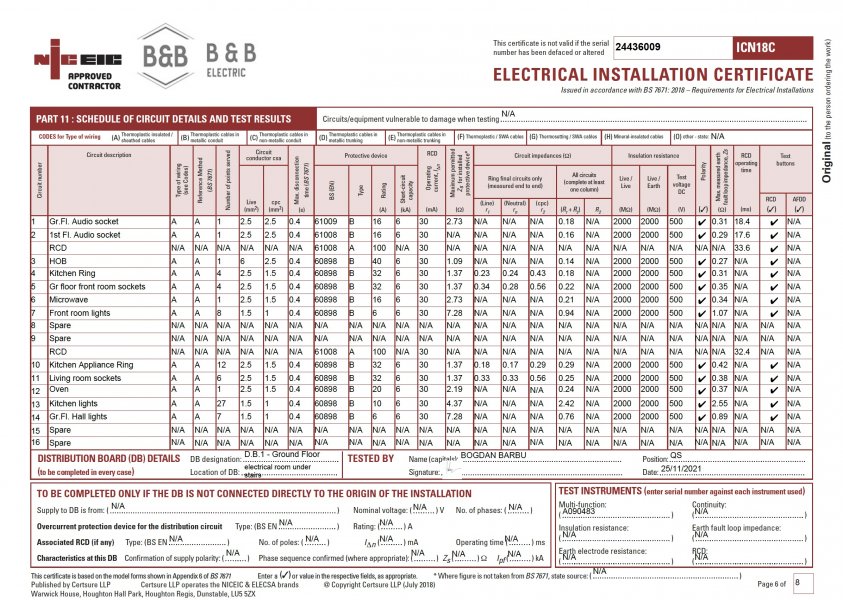

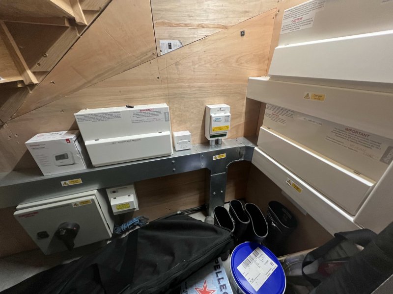

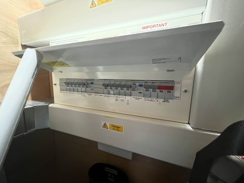

My installation is completely standard per our regulations. I have 400v 3-phase (3 x 100A) supply. We have an external wall-mounted box installed by the network engineers with sealed fuses before the meter (see the image - immediately after installation). My electrician then runs these through a set of breakers and then underground into the house. They go through a box with a master cut-off lever and then into a series of consumer units, two for the house, one for the utilities room and one for the car charger. There are 100A RCDs and breakers that I think range from 16A to 40A. Everything is mounted on marine ply in case of water ingress and housed in galvanic steel. Elsewhere there is a separate bank of isolator switches for all the kitchen appliances. Every wire and socket is tested, the complete system test took two highly experienced electricians 10 hours. You get a report, mine was 8 pages, filed online and serial number traceable to the registered electrical engineers who did the testing. Many qualified electricians are not qualified test engineers, so they get someone else to do it. There are labels giving the 5-year test cycle date, when everything gets inspected again.
When done per the regs, you should never have to look at it again. Unless you are a qualified electrician you should not be touching anything, unless you have to flip a breaker, and certainly not changing any of the equipment. If you have a fire or flood, turn the power off with the big black handle.

In answer to your question, every plug used in my system is BS1363 compliant and every fuse BS1362 compliant. They may be Bussmann, SEM, I can't say, I don't recall looking. They would have cost $0.30 each because they are mass produced by the billion to strict tolerances. 13A safety fuses are ceramic filled with silica.

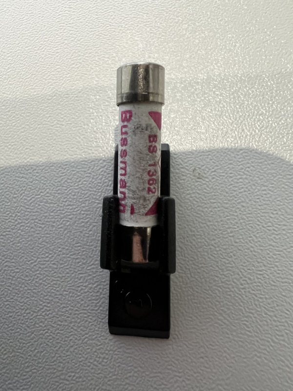

Is your whole premise you don't like QSA because they use a Bussman fuse that is not labeled Bussman.
I just looked at glass fuses I have. They are stamped Bussman and UL.
I dont know if Bussman has an OEM department where they would make a product for another company and not affix the Bussman name to it. I don't know if QSA is going to an OEM supplier to get the fuse and that is why it is not labeled with a manufacturer stamp.
China is pretty good at making things with labels, stamps and markings that look very authentic. Taking anything at face value does have risks. I only buy Square D circuit breakers at authorized supply houses or Home Depot. FWIW Home Depot sells more Square D circuit breakers than any commercial supply house. They get preferential treatment. I never buy them on Ebay, Ali or Amazon as they may be fake.
