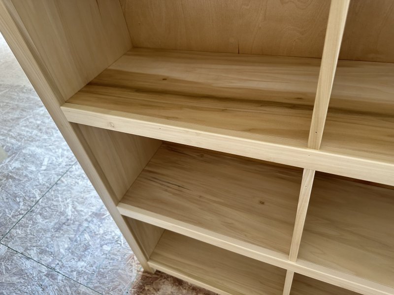

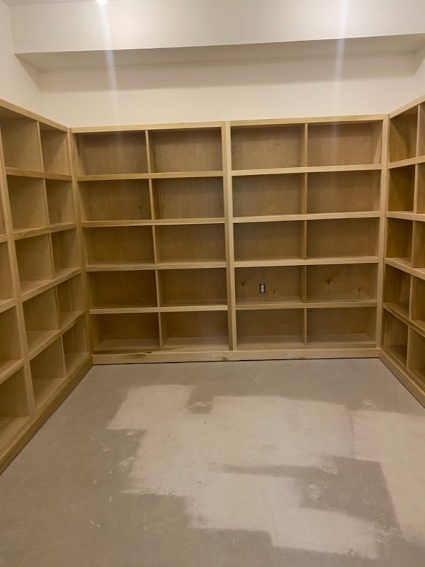

Well, we have records shelves. These are custom built by the carpenter. They are 14" high X 12.25" deep X 22" wide per cube. The Ikea rack is 15.25" high X 13.25" wide X 13.25" tall per cube. So these are nearly 8.75" wider per shelf. Thats a good number of records. Roughly 3 records per inch = 3X22= 66 records per cube (approximation/no box sets). Right wall = 60 cubes = 60 x 66 (records per cube) = 3960 right wall / left wall same = 3960, back wall = 20 cubes x 66 (records per cube) = 1320 records. Total: 3960 X 2 + 1320 = 9240. Box sets will sit on top. The measurements are rough but close enough. The carpenter did a few coats of shellac and sanded each layer make to sure things stayed smooth. He has a little more trim work and nail hone patching but done for the most part. I thought about lighting and will probably add some type of overhead LED on the top front of each cube or spaced apart, or something more decorative for each cube. That is another project. I opted to stick with the poplar wood as it looks very nice as is for a record or bookshelf. I did not think cherry or Mahogony would be worth the splurge since you would only see the face of the shelves and not the entire cabinet.
Thia room will get carpet, so I guess the shelves will be on concrete forever, but they have some type of footer system on each cabinet. Overhead lights are something called "Halo" lights that our electrician said was the best thing for nice even distributed lighting. Those are not the Halos in right now...just temp lights for the workers to work in the house.
