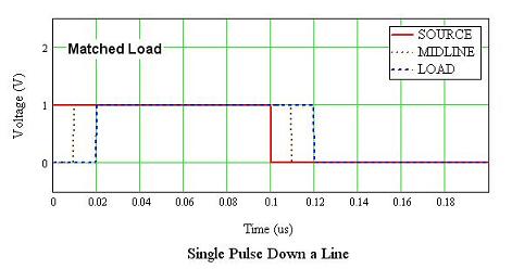

While looking over this, I realized I never got back on a question about voltages along the line and at the ends (source and load). Here are a couple of quick pictures that might help...
First, the test system. This is a very simple test, just an ideal source with real (resistor) output impedance, a transmission line, and resistor load. For this example, the source and transmission line impedances are both 100 ohms, and we'll vary the load. The source outputs a 100 ns pulse 2 V high. These are arbitrary, just making life easy. The transmission line is 20 ns long (about 9.5 feet for the parameters I plugged in; again, immaterial to this post).
This first picture is with a matched load (ZL = 100 ohms). The source pulse (solid red line) starts at zero and ends at 100 ns as expected. At the transmission line (SOURCE), the voltage is divided by two since half the voltage is dropped across the source resistor, and the other half across the transmission line. At the middle of the line, the pulse (MIDLINE, dotted brown) rises to 1 V 10 ns after the start of the pulse as expected. This is the travel time for the pulse from the source to reach the middle of the line. The load (LOAD, dashed blue) sees the start of the pulse 10 ns later, or 20 ns from the time the source pulse first hit the transmission line. Since everything is perfectly matched, there are no reflections, and the pulse dies away cleanly.
