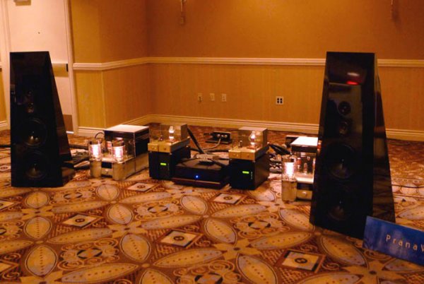

The Interocitor One saves the day again! - now with photos
Here are some photos of our system at THE Show in Las Vegas this January showing the Interocitor One in the setup.
