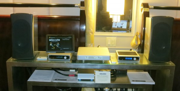

I found another use for the Interocitor yesterday. While setting up the display for CES, I found the need to have two different components driven by the same DAC. In this case, I had the prototype of the M2Tech Young DSD to drive both a Roksan Oxygene integrated amplifier as well as a M2Tech Marley headphones amplifier.
We had a Y-cable on hand, but not a good quality one.
Enter the Interocitor (Flex-Connect). It took the balanced output of the Young for input, and we attached a XLR-RCA adaptor to the balanced output. Switched the output to unbalanced, and used both outputs.
Voila! Two single-ended amplifiers driven by one balanced source.
