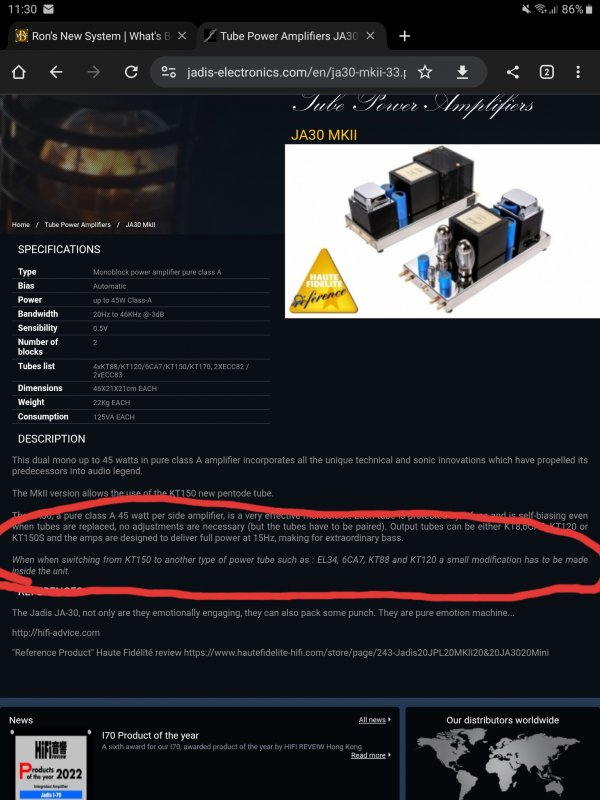

Hoping it works is not a good strategy. can be work in the amp or there are small fireworks when the idle current is too high.
Reactions: microstrip
Reactions: christoph
That suggests that the other 4 tubes listed can be changed without modifications, or?
My understanding is that the 4 tubes other than KT150 need modification, although a small one. I am guessing that small modification can only be done by the area distributor as I have learned from experience that Jadis does not disclose these mod info to the end user or public, otherwise, it would have been posted in various Jadis user groups.
