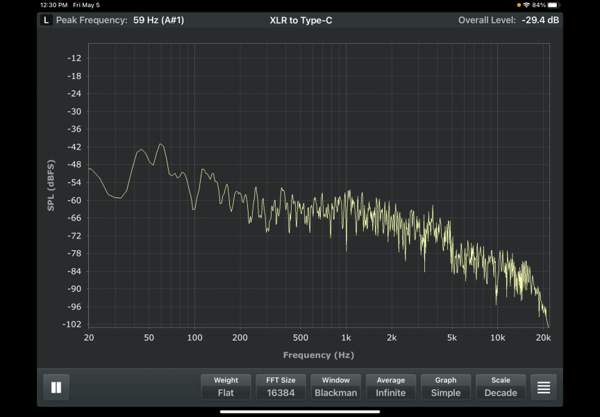

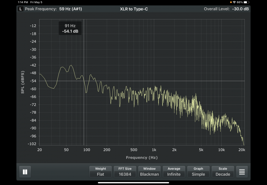

I’m not sure why Ron’s plot means much outside of major room nodes. It isn’t based on precise positioning of the Pendragons in the room to begin with. It also doesn’t represent how sound is spatially or dynamically in the room.
It does show the fr at the listening spot .. as far as you can with the iPad .. so it does show room modes at that point . Averaging around listening point would give a better picture.... I agree its only a small part of the story but an important one.
I still dont see how distance to back wall is responsible for the bump from 1-5khz ... anyhow we will see what Rons next move brings

Totally ... all first reflections within 10ms should be lowered in volume by at least 10db .. preferably more . This will assist unsmeared precise sound . Combined with a perfectly symmetrical positioning of speakers that others have mentioned you get clarity imaging etc.
I think Rons speakers are far enough from front wall .. you would then adjust them and seating to avoid low fr peaks and nulls at low fr... I think that has been done.
However I dont think moving them back and forth will change the bump above 1000 hz ( or is it a dip below) as they are too broad to be effected by these dimensions
I would be a fan of moving them further away from side walls as they are shortest relection path .. I also wonder about locating woofer towers inboard as they will have more reflective energy off sidewalls than dipoles .. that could be the the reason for the shallow dip centered around the 300hz or so .. via cancellation.
All just speculation at this distance :)

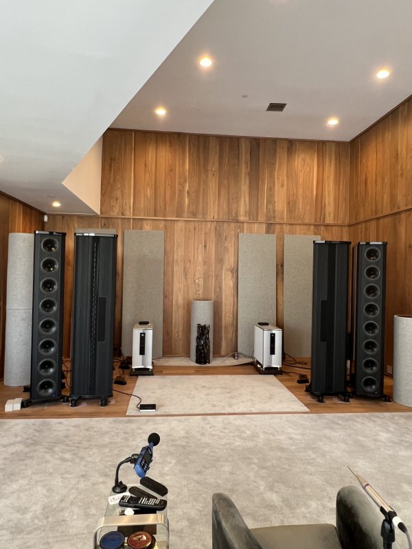

I placed on the front wall two 1" x 30" acoustic panels behind each ribbon panel.
BEFORE
AFTER
Reactions: Al M.
First album on vinyl is Famous Blue Raincoat.
I think the slight edginess is gone! :D (Y'all should have had more faith in me. Mechanical problems have mechanical solutions.)
Ron, which sounds better to you and why?
Shaving off some of the bass nodes room boom allowed me to raise the woofer tower level. These acoustic panels, which were selected to begin to absorb significantly at about 1kHz, I think have mitigated the slight upper midrange edginess on vinyl.
Subjectively the sonic center of gravity of the system has been nudged down.
I will leave it to people with ears better than mine to decide whether the four panels on the front wall are too much, and maybe only two panels are necessary.
Broadly speaking, I consider that the system is officially "hatched." I am done for now. Of course the big turntable has yet to arrive.
I may get a third AVAA. I've ordered custom TubeTraps with higher Q which will replace the standard TubeTraps I have presently. I may play with some additional tube swapping. I may get KR KT-88s for the amps. And I still haven't sorted out the ribbon panel toe-in puzzle.
Friends and guests will have to weigh in with their opinions. I will happily make changes if other people hear issues and suggest improvements. But as far as I am concerned I'm done with the big stuff.
