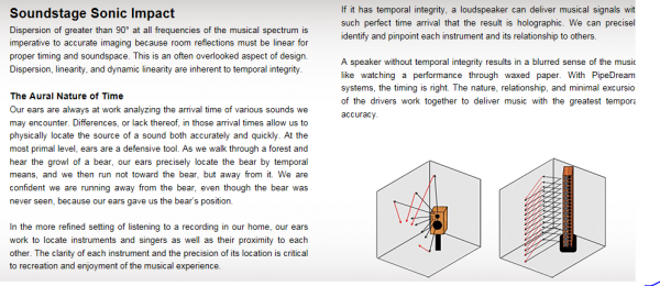

here is what the website says.....
(mods---if this violates copyright then please delete.....I'm fuzzy on that)

They're not dipoles.
Thanks. The question is that they only refer ambiguously to "dispersion greater than 90º", and we do not see any sound going through the back of the speaker to the back wall. Dipoles usually have a symmetrical radiation pattern - when implemented with dome teeters they must have tweeters in the back, as Linkwitz does in his open medium and bass dipole. It is why I am questioning.
and why I put a question mark on my comment. :)
Thanks. It is bad news for me and my Soundlabs - I never managed to make a good blend between dipoles and subs, excepting the ESL63 and the Celestion 6000 bass dipoles. Perhaps this specific pattern explains somewhat why Marty managed so well to match them with the JLAudio's - they Pipedreams were designed as part of a satellite/subwoofer system.

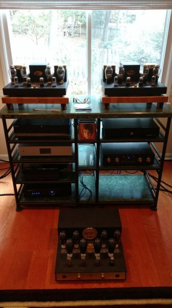

I finally got the time and muscle to move the stereo equipment to the 11x20 room with the higher ceiling. The difference was very nice! I will post more images and information when I get a chance. Also, anyone happen to have 12 6SN7 tubes that they don't need that are all matched? I got another VAC 70/70 Renaissance amp and would love to match the tubes.

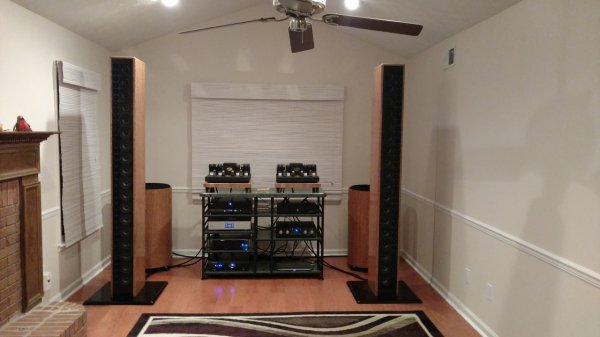

Well, I have taken some pictures hopefully this weekend I can take some measurements and get to work on the rest of the work involved in making a great sound room. I might be moving my rack, but cabling could be complicated if I do that.
So back to an old thread! I have moved listening chair closer to the speakers (about 6 feet from the back wall), the rack is on the side wall but will move to the back wall. I would like to do acoustic room treatments; however, I want to measure the room and do this right.
Is there anyone in the area that would be willing to help me get started with taking measurements / has a microphone I can borrow? If not, can I get some recommendations on a good mic to use? I plan on using REW and have read a fair amount on how to get started. Looking forward to recommendations / any help I can get!
