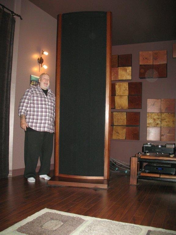

Post deleted
I think some of us feel that it is tad disrespectful to keep posting pictures of Acoustat speakers and talking about your perceived impressions that Acoustat are the one and only superior electrostat speakers in a thread that is supposed to be about Sanders.
