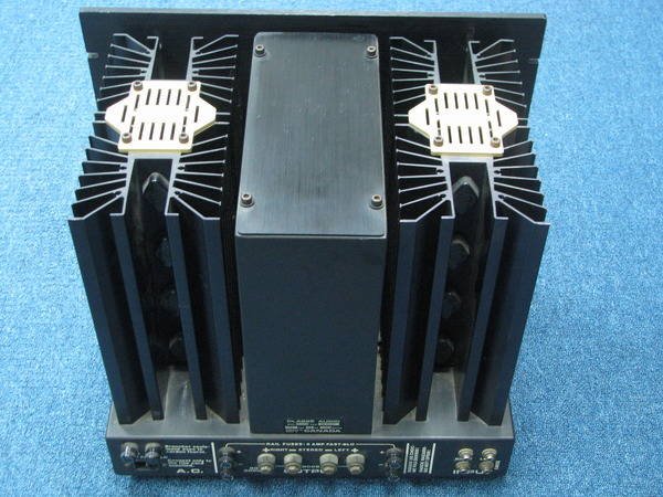

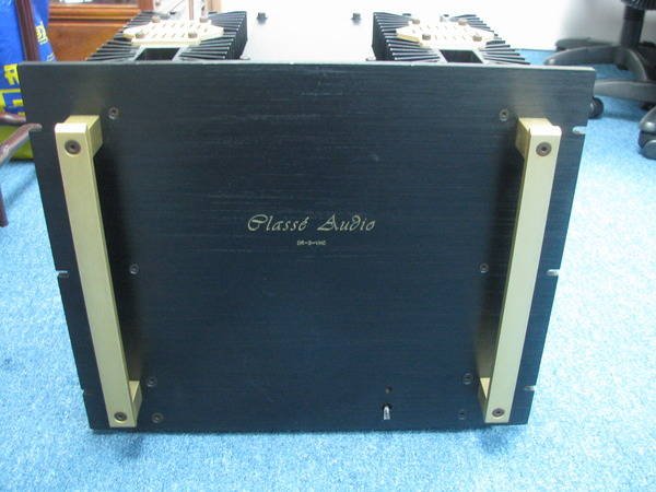

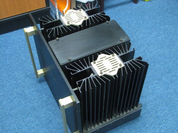

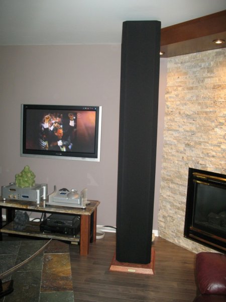

i had a DR-2, it was a honey of an amp, wish i still had one to drive my quad 57s.
