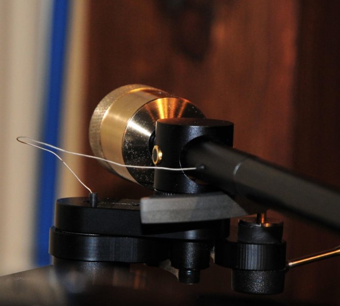

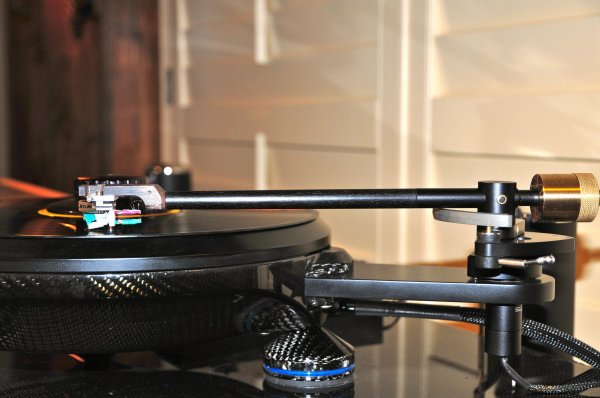

John, do you have any idea as to the weight of your arm? I ask, as I would love to try one on my Linn...which I am now in the process of bringing up to SE spec. The Linn arms do nothing for me, my WTA beats the pants off the Ekos and it's still not in Schroder territory.
Just some observations from the pictures:
1. The cueing lift looks like it is actually touching the arm when the record is playing. If not, it's oh so close.
2. What is the white mung around the bottom of the armboard that is visible in the picture?
3. I assume that in order to set up the arm correctly, the arm had to be mounted to the armboard in such a way that the arm actually looks like it is making contact with the back of the hole in the armboard instead of being centered in the hole.
Hi
#1, it's not...about 1/4 inch clearance...must be the angle and the lighting...
#2 just the machining marks and not a good touch up paint job...can't see it unless you're on your knee's looking up :)
#3 the hole is just a hole...needed to make it bigger to get the alignment right....the part that grabs the arm spindle/bearing tower is a triangular bracket that is secured from the top of the board...you can't see the hole from normal viewing positions...

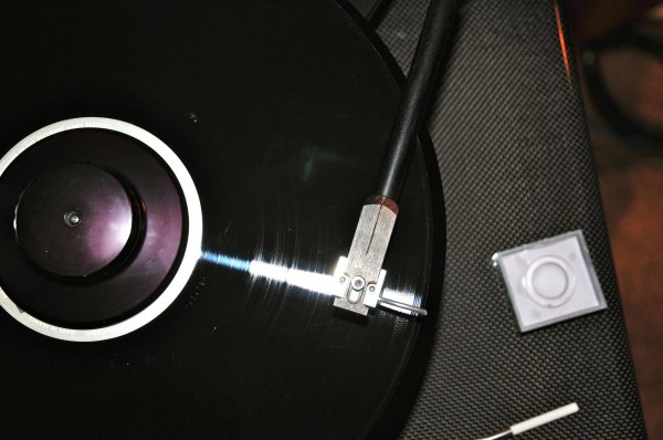

John, does it look like there would be one null point? Can you post a picture from above with the cartridge about midway into the record? Also, I assume the cartridge is underhung? If so, by how much?
how's this pic? And on null points...I guess you could say only one or at all points on the record the null point measures out the same...as far as underhung...does the first pic on on top of this thread help at all? The flash created the linear line...that wasn't planned...but is fitting :)
great photos...I am not a vinyl guy at all...but still always fun to read about SOTA pieces that take even a seasoned audiophile by surprise...seems like quite a leap in performance. Congrats.
I was hoping for a picture that includes the pivot point as well. Schroeder claims zero overhang, though for minimum distortion the cartridge should be underhung with a straight arm like this.
It feels like your pivot point is not set up the same way as in the picture.
Also not sure what you mean by "you could say only one or at all points on the record the null point measures out the same" - this is still a pivoted design (right?), not a true linear tracker, therefore there would be at most two null points.
It has two pivot points not one. A picture will not help much. A video however would help you understand how it moves. It moves in a straight line across the record because the arm articulates at two points at the base. I have not seen the inner mechanism so I do not know exactly how it works.
This is the tricky part - it must have some kind of servo to keep the main arm tonearm pivot in the proper tangential position.
This is the tricky part - it must have some kind of servo to keep the main arm tonearm pivot in the proper position.
Nope. Extremely good bearings and I think some kind of guide bar. From what I've heard magnets are involved in the equation as well.

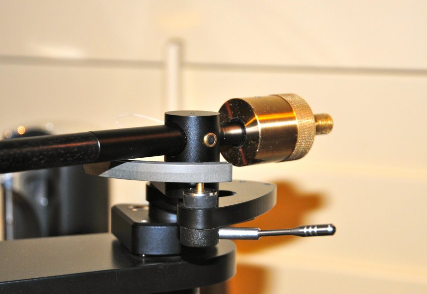

Yeah...look at the 3rd pic from the top. Show's the mechanism under the armboard. It does have a guide bar that allows the 2nd pivot to slide sideways (vs a pivot). it's a bearing in racetrack...with magnets that keep the bearing from touch the track during playback. When you're cueing the arm for play...you can feel when the movement exceeds the limits and the bearing hits the side of the race track.
During set up we had a protractor with the normal 2 null points...but a straight line vs the normal arc we're used to in pivoted arms. The difference with this arm vs a servo driven or other tangential trackers is the back of the arm doesn't walk with the nudge from the servo of the glide down a air bearing shaft...in this arm the back glides as easily as the front of arm with the stylus in the groove...so when get the leveling right...the front and back move together, in unison, across the record surface.
Now the REALLY cool thing is you can hear the inner grooves now without distortion. The clarity/resolution doesn't change as you play the lp. It's a MUCH more enjoyable experience.
Plus the arm just sounds better than any i've had. The dynamics are strartling. The ability for the timing and volume level to change...you feel like you're with the ensemble playing...immersed as part of a live performance...

Ack, I am guessing Steve Dobbins or Frank Schroder might have a diagram like yours above. Maybe showing how the rear arm slides like the front of the arm...Audioarcher is right...two pivots for sideways movements...(3rd pivot for up and down)
