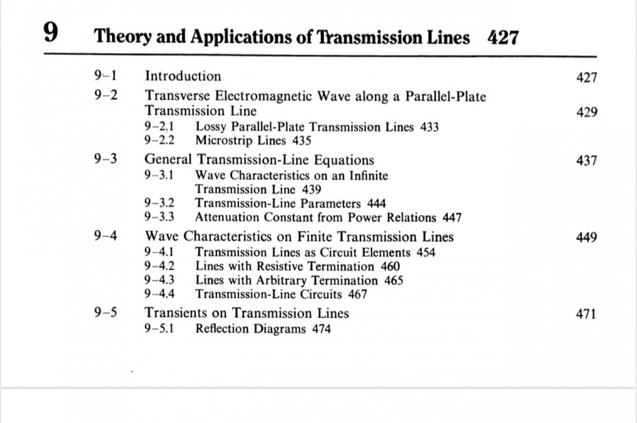

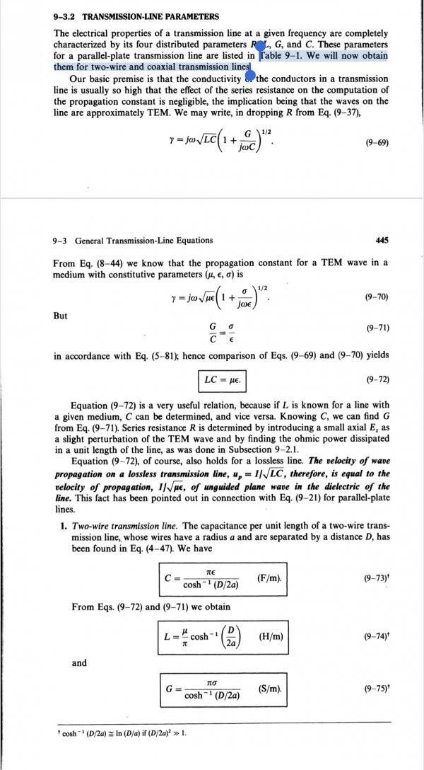

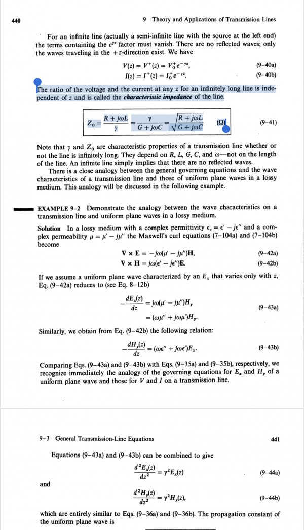

these pictures are from chapter 9 of cheng's Book :
Starts from Page 427
The equations :
The ratio of the voltage and the current at any z for an infinitely long line is inde- pendent of z and is called the characteristic impedance of the line.
Table 9-1. We will now obtain them for two-wire a n d coaxial transmission lines.
The coaxial parameters :

Thanks - at some time in my professional life I had to teach EM, Maxwell equations and equations similar to those you display to my students. I even assembled an experiment to study the propagation velocity and characteristic impedance of cables.
You are just trying to create confusion with basic mathematical and physical theory to dazzle our members that are not experts in physics. Bye.
Page 441 and 442 and 443 describe the distortionless line and the important key is the cable parameters (R, L, G, C) across the line should be constant.
