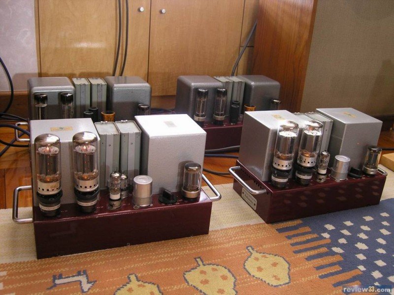

Yes , I understand this to be the case , I came to my own Cortese F2a having spend some time with the Siemens F2a11 valve modifying vintage Audiomaster 11A mono blocks to run the Siemens F2a11 instead of EL34’s in those amps, via socket adaptors and a couple of component changes , this was all the rage amongst a couple of guys on the Review 33 forum at one time.I once had a monbrison, a friend also, really good preamp you don't need more to listen to music. but they 2 monbrison looked different inside other components. not meant to sound bad but he used what he had in stock to build the amps. the f2a poweramps are a masterpiece, one of the best tubes ever made from siemens.
This tubes runs 30 years without problems, good choice and nice amps.This is a pair of Audiomaster 11A’s adapted to run the Siemens F2a11 owned back then by Marantz7c ( forum handle)
Apologies for the slight Off Topic .
