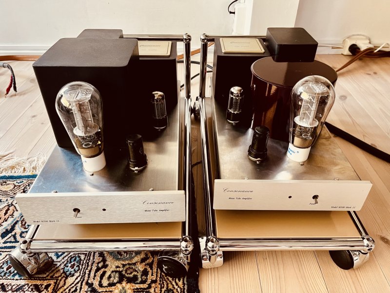

Both Hørning OPTs are now in place and the stock OPTs are history. It´s been a productive day.
Picture of the first finnished amp with the Hørning opt under the dark red cover side by side with the standard amp.

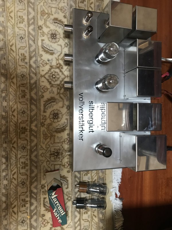

Intensive weekend of listening with the Silvercore amp on the Horning speakers. Had several friends over last two weekends to join me (Acousticsguru, Christoph, Phonatix, and others not on WBF). Just did a lot of tube rolling of rectifiers and so far the three best that I own are the following:
1945 RCA 5R4GY Blackplate
Marconi (Canada) Blackplate 5U4G (not sure the year)
1955 Valvo metal base GZ34
Interestingly, the plate structure of the RCA and Marconi are VERY similar, despite being to different types of rectifiers. They are more similar visually than to other 5U4Gs. Sonically, they are much more similar to each other than the GZ34.
