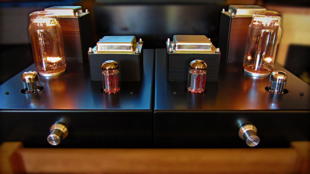

26 watt class A 1 6em7 driver gm 70 gz 34 tube rectifer is enough for me0158 Front.jpg

26 watt class A 1 6em7 driver gm 70 gz 34 tube rectifer is enough for meView attachment 138716
