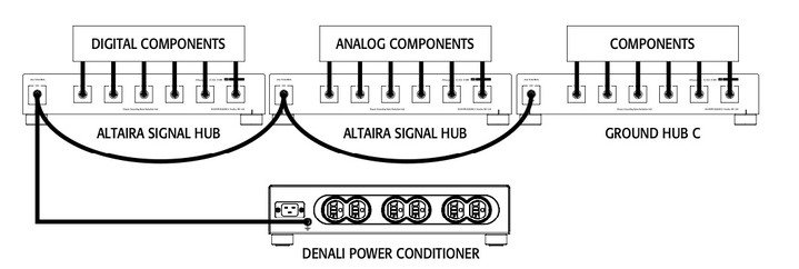

In the Shunyata diagram for segmented grounding there is still a CG in the system:
Thank you. I appreciate you taking the time. In the interview on YouTube, he states the opposite of this and goes on a long time about the differences of chassis vs. signal grounding. I will continue to study, think and then maybe just experiment. If what you say is true, they could fix this so easily by just stating plainly without uber-complicated diagrams and flow charts that read like Kafka novels (if yes to 4 visit 3a, if no go to box 37b, etc.). They could just say plainly: if you are only going to buy 1 get a CG; if you want more than one, get a SG. That seems to be what you are saying….
It’s been a while since I’ve seen the YT video; but he’s talking about where to ground (I.e., the chassis or an input/output on a component), not whether to use a Signal or Chassis Hub. If in doubt, just email Shunyata directly (do not listen to you your dealer!). Richard will confirm what I’m saying,
Yes, that’s right. Shunyata are saying that if you have a “[Mixture of] Components”, connect them to a single Chassis Hub.
Note that the two models of Hubs are Signal and Chassis - there is no such thing as a “Ground Hub” - more confusion!
Anyway, you can clearly see all “analog components” (for example, a preamp and an amp) should be connected to one Signal Hub.
What does the third hub in the diagram represent/do?
You mean “Ground Hub C”? That must be the Chassis Hub, just with a labelling error. They are saying that a mixture of analog and digital components should be connected there (assuming there are no available terminals on Signal Hubs A and B).
Ground Hub C in that picture should read "Altaira CG-NR" (chassis ground hub) for clarity. In that picture it is provided not only a better grade of chassis grounding filtering but also more attach points. You'll note the Denali only has 1 (as does the Typhon T2 when present). My next step is to add this an Altaira CG-NR. Ground Hub C in the picture should not be utilized for signal grounding (it's not optimum as the CG-NR hubs are not tuned for the higher frequency signal domain noise; this is per Shunyata).
