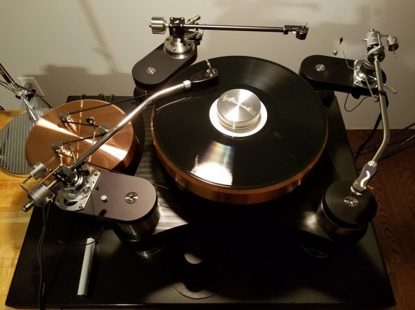

You guys must be very tall. I can never get a picture in that angle.
Tang :eek:
Tang, He could be standing on a chair to capture that view.
It is a nice image. It's very interesting that the arm board has the cutout for the SME sled rotated at what looks like 90 degrees to how David's arm boards are cut for the 3012R. IOW, the SME slot is perpendicular to the axis of the arm board while it is parallel on David's boards. Just look how these arm boards are turned compared to Tang's which go straight out away from the spindle. On my SME arm board, that slot for the sled is offset from the main axis by about 15-20 degrees.
Perhaps this was addressed earlier in the thread, but what is the purpose of that smaller counter weight on the outrigger arm? Is it to balance the arm because the arm tube is bent and the cartridge off center relative to the axis of the arm tube? I notice that the knife edge bearing is not offset to match the offset angle of the cartridge as it is in the newer V arm. Would that make a difference for the outboard smaller counter weight?
And in general sense, why is the arm tube bent rather than just rotating the headshell at the end of a straight armtube? It seems that many vintage arms often had this "J" or "S" shape while modern arms have an offset angle at the end of a straight armtube. Could someone explain what seems like this evolution in tone arm design?

The outrigger weight is for setting tracking force. It is set to zero until the arm is dynamically balanced using the big counter weights at the end of the arm tube. If you balance it right, when you set the outrigger weight to the desired tracking force, then you will be spot on for VTF and don't even need a scale.

Thanks, Christian. Why is that outrigger off to the side if what it does is VTF? Could it not be above the centerline of the arm? I think it can be rotated around the axis of the arm. And, don't the big counterweights balance the arm statically, not dynamically? I can balance my arm either way, statically, or dynamically. Dynamical balance is with the spring applying VTF after the arm has been balanced to zero, or floating, with the counterweight. Static balance is with the spring set to zero and the VTF applied with the counterweight. If I use dynamic with the spring, I don't need a scale either, as it is calibrated and extremely accurate.
So, my question remains, why is the outrigger off to the opposite side of the cartridge? I never see it in any other position. Does it not have something to do with the bearing not being at the same offset angle as the cartridge?

The purpose of the side weight is to counter the tipping effect of the cartridge weight due to the tonearm J-shape, and thus to ensure that the knife edge is properly seated in the saddle and its weight is evenly balanced across the saddle.
The counterweight including the side weight on its outrigger can be adjusted transversely to achieve correct lateral balance for any cartridge weight within the design range. Once that is done per the instruction in the manual, then the knife edge bearing will be properly mass loaded.
The disadvantage of the vertical bearing not offset the same as the headshell, is that a change in arm height will cause a change in azimuth.
