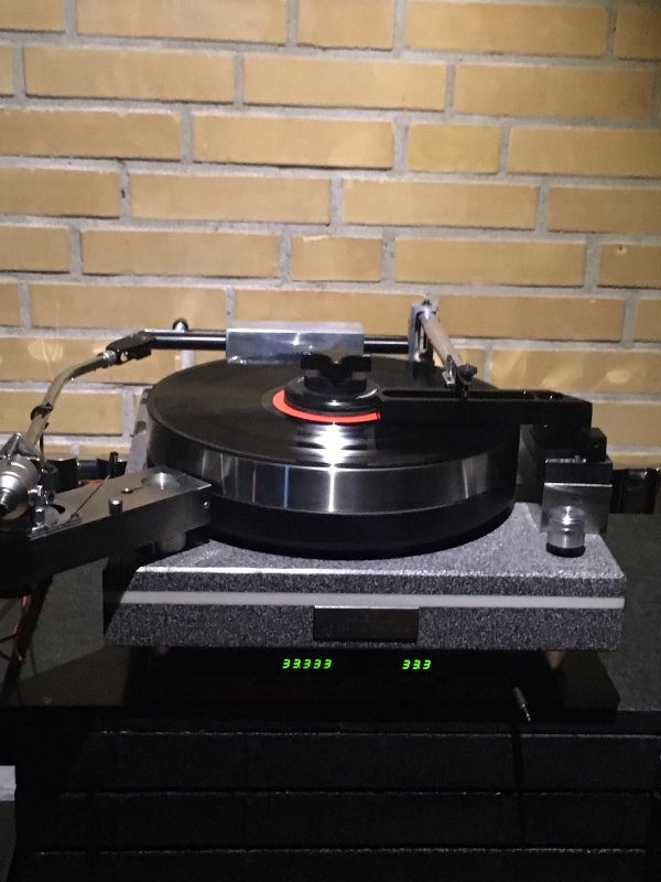

I think the silver arm lift models are the early ones that also have the better sounding rca cable. Mine is also a late model with black arm lift. You are not using a lot of anti-skating that is for sure ;) View attachment 71407
Hi Lagonda, Well, the vdh Colibri cartridges recommend very low anti skating values. Mine are 0.2-0.4 grams. I set mine at the lowest level (0.5g) and have recently found that 0.75 is better. That is the second notch on the scale in the photo.

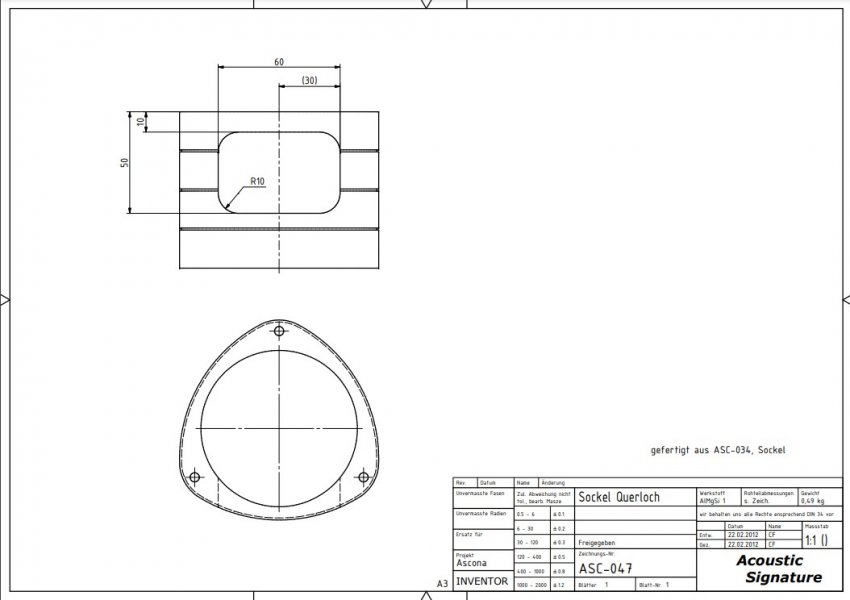

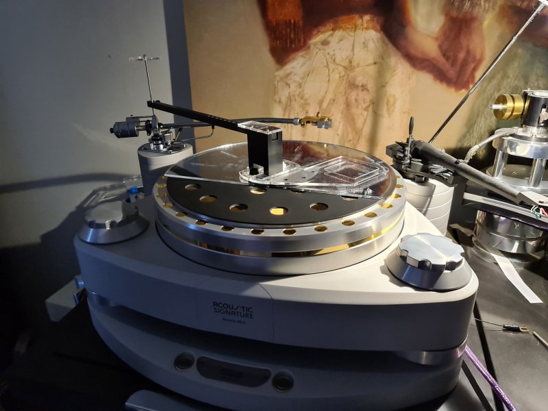

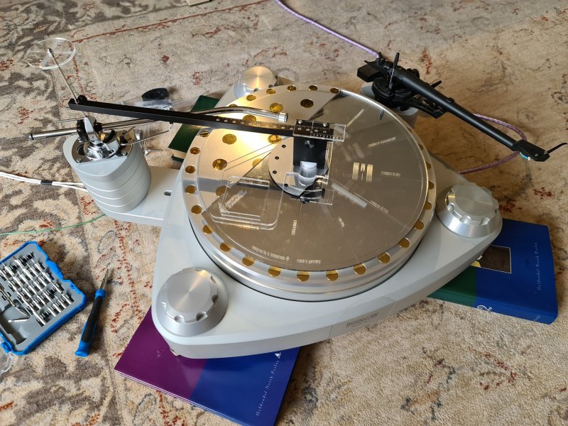

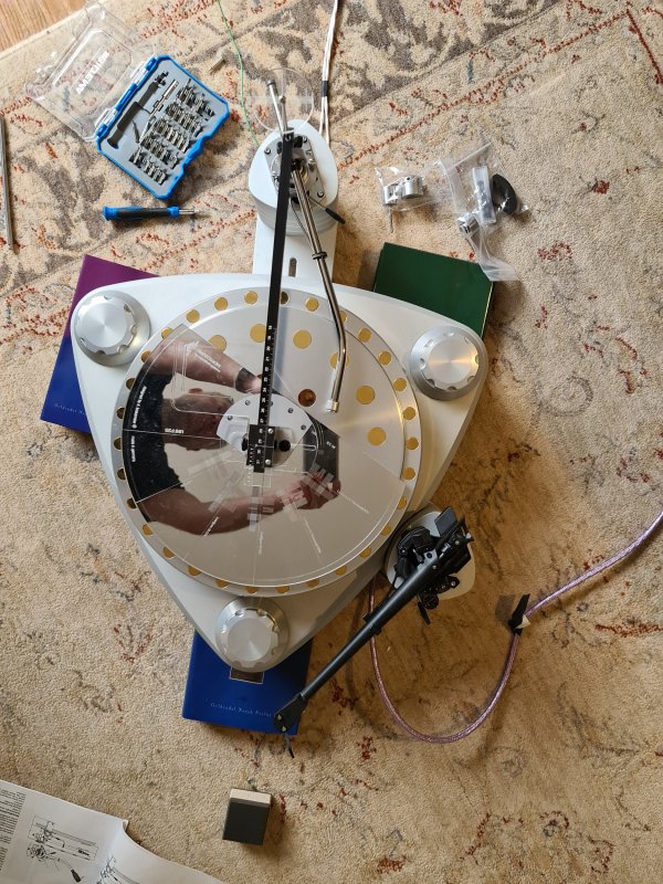

Finally got the SME 3012R mounted on my Accoustic Signature Ascona. Tonearm bought from Japan and looks like new. Just starting to spin. Thank you @hogen for your kind help!
Congratulations. How did you manage to connect the side facing rca connectors on the3012 to your phono leads inside that tower? When I had an Ascona it only worked with the bendy SME cables otherwise there was not enough room inside to turn 90 degrees..
Thank you! I had to rebuild it to make rca connectors face downwards. Tried also with original cables or angeled rca plugs, but space is too narrow for the arm to slide back and forward.
Ah ok. Acoustic Signature actually makes an armboard with side holes that match the sidewards rca plugs for the Ascona.
