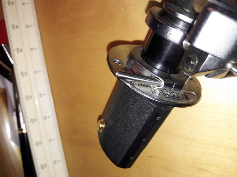

Not just the packing, I can assure you. They also labeled the tonearm bases - see my Series II SME 3009 R base. The intention of having a series 2 R model is clear. sme_R_series2.jpg
Here is the history of the 3009/3012 arms and their different versions:
I think the reason 3012R arms have the Series 2 dedication is because SME started making the 3012" improved " model in 1972, with aluminum tube that was actually considered inferior by many to the earlier series 2 arm. They then went back to the heavier series 2 with steel tubes in 1984 with the R arms o_O
