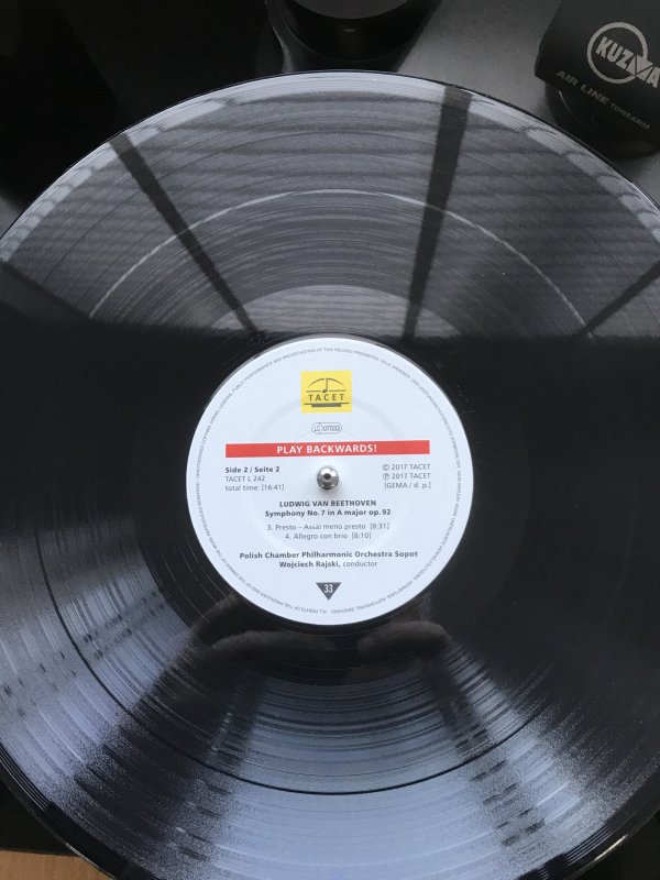

I cant say I have this problem however you may find this Tacet label interesting !

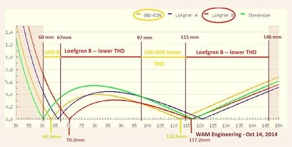

Apart from the arm quality and tracking issues, there is the question of where on the groove do you want your distortion to occur?
You actually have a choice albeit a small one based on the tangential alignment curve you choose for your cartridge. Along with the LoefgrenA DIN, Baerwald DIN and Stevenson curves, Dietrich Brakemeier's UNI-Din curve was derived specificlly to address the 'greater distortion at the inner groove' issue. UNI-Din is available on the UNI-Pro and SMARTractor protractors.
Of course there are trade-offs and compromises to each alignment curve choice, with greater higher or lower distortion occuring, for example, at different places during the beginning, middle, or end of an LP side along with the notion of overall and average distortion. And there is the question: is one curve better for a certain type of music than another?
Rather than go into detail here, let me point you at a couple resources.
Attached is an article (pdf) by Brakemeier explaining his approach and why he created UNI-Din. In effect it is a curve in a context, a context not available at the time of Baerwald or Loefgren, whose curves were designed when the mono shellac 78rpm record was the standard. Yet even today they are considered by many a 'best compromise' for arm/cartridge set-up. Imo, the article is very interesting and worth a read. I play mostly classical music and often use the UNI-Din curve to align a cartridge.
Then, below, is a helpful diagram created by Wally Malewicz that shows visually each curve across the length of a record and where it has its distortion. Copy this picture to your device and enlarge it to see it better. It has an accompanying link by Fremer.
Note: lead-in groove is on the right, end of record on the left.
UNI-DIN Versus Löfgren B Just to Clarify

Fascinating - this is exactly what I was trying to describe in my much less learned and amateurish response of 2 Jan! I had no idea that the Tacet company existed, far less that they were exploring and resolving the end-of-side distortion issue I described. Perhaps they might have given me a job... I suppose one problem with backwards-playing records would have been applying reverse anti-skate; another would have been the popular market for auto turntables where reverse play might not have been possible.
Ain't this just a great hobby?
Thanks very much for the post, Tima.
