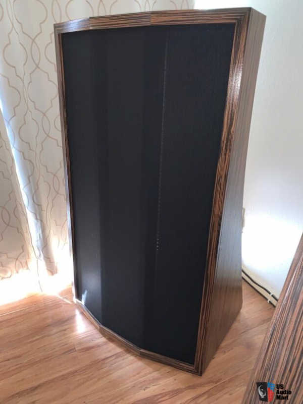

With all due respect, your view on full range planars seems to be somewhat poorly informed. With appropriate electronics and power (yes the electronics and power have a big impact on whether sound "sticks" to a speaker or not) the strengths you mention are not offset with "gluing" the far left and right to the speakers. While I have horn speakers now, I have owned a large number of full range and hybrid planar speakers, including: Audiostatic ES100, Acoustat 1+1, Spectra 2200 and Spectra 4400, STAX ELS-F81, Apogee Caliper Signature, Infinity IRS Beta, DIY BG ribbon + woofer. Close friends also owned: Apogee Diva, Apogee Grand, Apogee Studio Grand, Apogee Scintilla, Apogee Centaur Major, Apogee Duetta Signature, Many different Magnepans etc.
If the sound "glued" to these speakers it was when the electronics were not good enough usually or particularly poor rooms but it had nothing to do with the speakers themselves. While the hybrid speakers were relatively coherent at least through the mids and highs (my BG hybrid was a single driver from 300 hz and up) the Spectra series Acoustats were the most coherent and overall best sounding, IMO. They could completely disappear sonically even though visually imposing.
AFAIK, the Acoustat Spectras were unique in that the panels where electrically segmented, which they could do because the stators were wires and not mesh, so the highs only came from a narrow part of the panel and the mids a larger part and the bass from all. Very creative way to get a wider sweet spot from a wide panel...much more effective than curving the panel.
It is obvious that you need space behind a dipole, whether planar or otherwise...this is just a requirement of the design and neither a positive or negative.

I owned Acoustat X, Acoustat 1+1 and 2+2, ML Monolith IIIs and reQuests. I should not have sold the 2+2s as they were the most coherent and best of the 5 stats I owned. It's not just power but the ability to provide the right power. I remember hearing Monolith IIIs with big SS McIntosh and Levinson amps in two audio salons. They sounded terrible, scrawny, in the box no dynamics, no body (why they hooked up this combo I don't understand). I used a Counterpoint NPS400 modified which drove the Monolith beautifully despite my criticism of them I've heard the Alsyvox speakers and the sound was suspended in the air out of the box with great dynamics (I only heard small combo though). I still prefer the Von Schweikert Ultra 9 and 11.
Reactions: morricab
Spectras were even better sounding than the 1+1 and 2+2. More transparent and better dynamics. The Acoustat X were with the direct drive amp? You still preferred the 2+2?
First, I purchased the Acoustat X for my birthday in 1981 from a dealer who I was friends with. My late wife called them coffins (yes, that's what my black cloth/oak cabinet Xs looked like). Yes, they had a built-in great amp; however, there was nothing above 1K(?) when standing up and the amps blew twice in a year (giant caps and tubes). Couldn't live with it's problems. Yes, best dispersion and out of the box sound of the five stats. I had no repairs or difficulty with any of my future stats and they were not terrible looking (ML went into dedicated listening rooms). I upgraded though when I bought the Xs from Audionic M-33 transmission line speakers which were only 81db efficient (the sound never came out of the boxes). Below photos of Audionics and Acoustat X 1667509212840.png1667509438427.png
