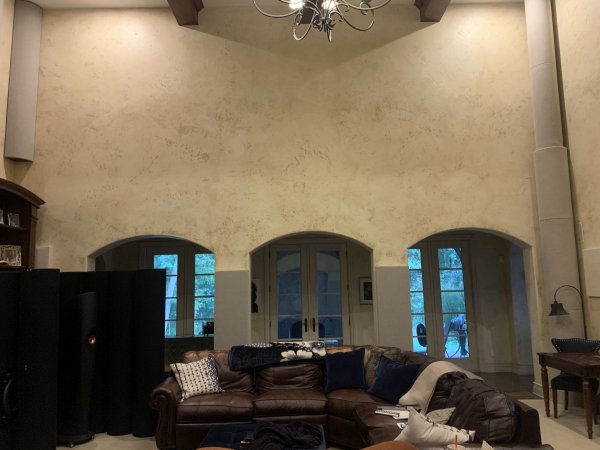

My room is big , 28 ft by 22ft with 20 ft ceilings open on 3 sides by arches to adjoining rooms .
The subwoofer pair is placed , phase and vol adjusted by Barry Oder , the sound doctor. The crossover is at 80hz.
The room is acoustically treated and tuned by asc tube traps . Design by Jordan Goulette and art noxon over a period of 1 1/2 year of adding and rearranging tube traps and treatment .
The vivid are ported speakers , I use my blades with the ports sealed . I want to get sealed speakers to be able to best integrate the subs .
I don’t want to make a lateral move . I listened to horns the most recent being auditorium 23 cinema hommage driven with shindo electronics and It was great but not my taste . A lateral move imo.
I am looking for a speaker which would do everything the blades do even better in a bigger scale . Not color the music .
Pics of my room
Thanks everyone for your recommendations .
I am worried that the Sonja 2.2 may be difficult for me to drive and the m3 May be very clinical .
And the yga crossing over at 60’s make the bass units obselete the way I have set the Jl subs up with masterly craft from the Sounddoctor.
What a magnificent space! Thank you for posting those photos.
I see now why you need a LOT of low-frequency capability. Not only is that a very large space, but if it's open into adjoining rooms, then in the bass region your speaker system is working to fill ALL of that adjoining airspace as well.
I use my blades with the ports sealed . I want to get sealed speakers to be able to best integrate the subs.
Are you using the CR-1 to roll off the bottom end of your sealed Blades? Or are the Blades getting a full-range signal? I'm guessing the latter, since you are considering other full-range speakers.
I listened to horns the most recent being auditorium 23 cinema hommage driven with shindo electronics and It was great but not my taste...
I have not heard the Auditorium 23 Cinema Homage, but imo there are other horn geometries which are more likely to do everything you are looking for (everything the blades do, and some things better, and on a bigger scale, while not coloring the music).
In your photos it looks to me like you have some large room treatment devices positioned sort of in a semi-circle around each Blade, presumably to address the off-to-the-side and around-back energy coming from the Blades. A loudspeaker system with well-controlled directivity could avoid sending significant energy in those directions to begin with, and reduce or possibly even eliminate the need for as much acoustic treatment, and thereby give you back a bit more of your magnificent room. Avantgarde, Odeon, Diesis, and Cessaro come to mind.
The speakers you are recommending are all horn speakers. I haven’t heard any of the above . I am planning on hearing them before I decide . I know that have great dynamics micro and macro . But do they have the sound stage and focus that dynamic speakers offer . Planar speakers I have listened to dont.
Thank you for your compliments on the room . And your recommendations
