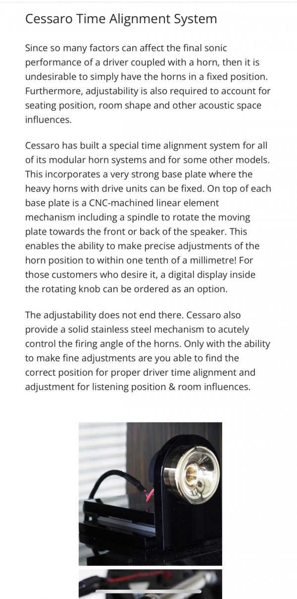

Please show me one piece of data that says the Avantgards are time aligned, just one.
Actually, both of you have misconceptions. A speaker can only be time aligned if the drivers are the same distance from the listener AND they are in phase. High order crossovers will disqualify from all sounds reaching the ear at the same time. There are several truly time coherent speakers (mostly from Thiel and Vandersteen) that don’t have adjustable drivers but assume a certain listening distance range to still deliver essentially coherent sound.
If Cessaro or Avantegarde use higher order filters they are NOT time coherent...same for Wilsons...you can adjust until the cows come home but without correct phase there will be no time alignment...period. This gets lost in the marketing blah blah and BS from JA in Stereophile but it’s physics.
Cessero. Time aligned and in phase.
Reactions: Brad OToole
How do you know?
It’s core to their design principles. You can read all about it on their website. Avantgarde, however, is not time aligned or do they claim to be on any of their marketing materials.
Exact,cabasse had already managed that 40 years ago, a time-correct physical baffle +time and phase-correct filter is not rocket science.;)facf7a2f487d4ba050276adc6669da4f.jpg
Right
Right! We were just talking about time alignment. Even if you are perfectly phase aligned (which I think is impossible, across all frequencies), you still need time alignment. In other words, you need both physical time and phase alignment.
Phase can also shift at the preamp and amp… all fun stuff!
There is not a single word on their website about time coherence or alignment. There are some pictures of a couple of new models with adjustable driver distances. As I have stated, this does not make a speaker time aligned if the crossovers are not appropriate. The crossovers are not discussed at all. So, maybe yes but probably no. No independent measurements available to see if their current models are remotely so (note the old models are mostly not adjustable...at least not easily.
