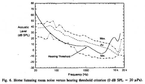

A real nice listening room might have a 20 dB SPL background noise level.
But most rooms have a 30 dB or high SPL background noise level.
Classical music recorded in a concert hall is lucky if it's much under 30 dB SPL.
What weight?
