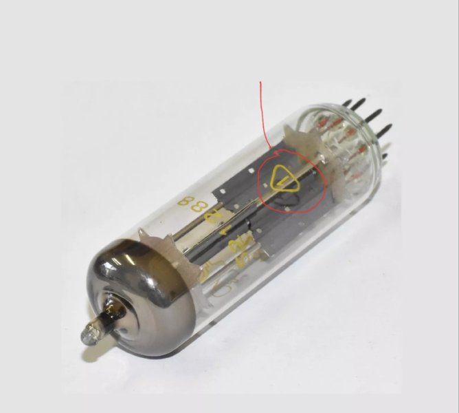

Re. EZ81/6CA4 tube, I would suggest trying RFT to Zanden 3000/mk2 owners. Installing these in the power supply, I don’t miss Mullard…
120% agree i use them in all devices.
Attention only use the tubes label (1)extremely high quality were only intended for export from the GDR.20241217_084042.jpg
Reactions: Marcus and nrzo
