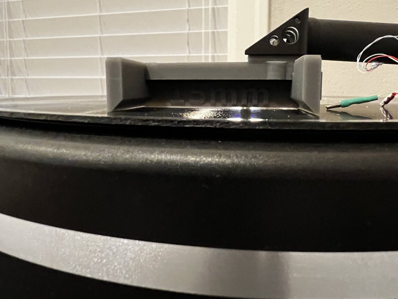

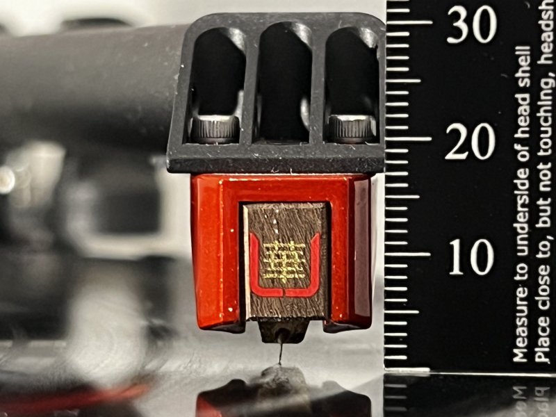

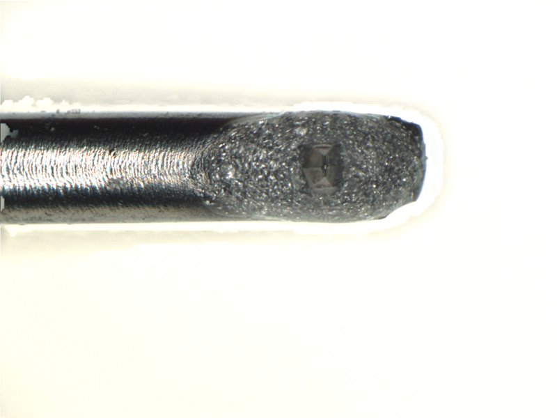

Now that I'm finally into the weekend and not distracted by silly things like work, I can finally unpack the whole WAM service. JR included a little box w/ additional shims and a USB drive -- when I first started exploring this service I felt a little shy about the price, but I think these pictures of my cartridge from JR's analysis shows what you get for the price.... and if I could tell my 1-month ago self, it is an absolute bargain for this level of professional analysis and well worth it:
Multifocus Image - 1_000 copy.jpgMultifocus Image - 1 copy.jpgChanUR20240603203046859.jpg
I mean.... shit, I paid more last year for my tax accountant's sloppy work (she mixed up my return w/ another client's)....
View attachment 132384View attachment 132385View attachment 132386
Have you listened yet? I noted a much more clean and intelligible playback. Well worth the investment. Eapecially for someone that wants to feel confident they have installed the cartridge very close to optimal. You can still dial by ear if you like. Only now you know how the cartridge was manufactured and where you should start.

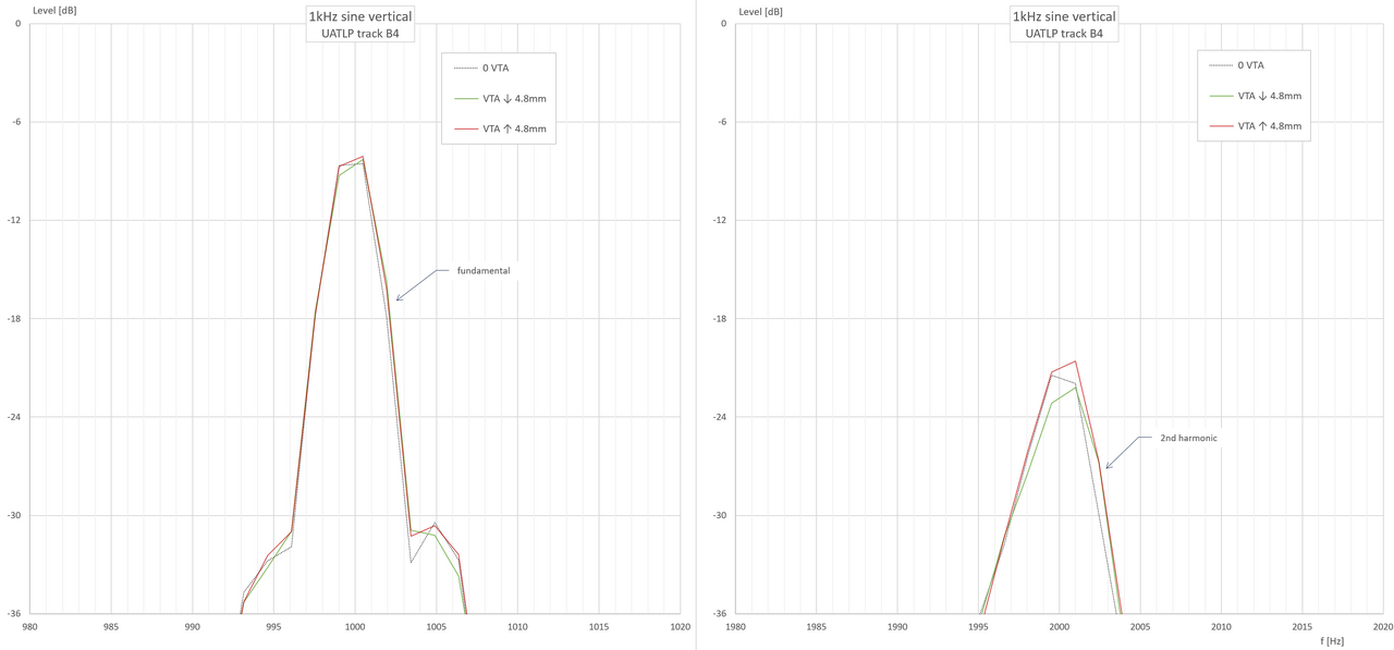

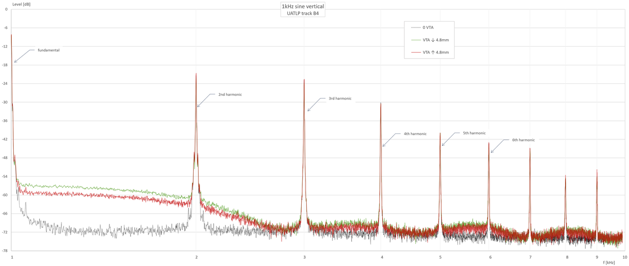

I thought it may be interesting with a follow-up of VTA adjustment using a test LP.
You are on the right path. Keep going!
I tried several methods and several test LPs. Some results from what should be most relevant below.
All measurements are done with line contact stylus and a Kuzma 4Point tonearm. I have used both Lyra Atlas Lambda and AT33PTG/II.
Study of waveform of the vertically cut 1kHz sine on track B4 of UATLP. I measured with 0 VTA, -4.8mm VTA and +4.8mm VTA
This is a typical halfwave with different VTA:
(the above measurement is quite course because I was using a Fnirsi scope with quite low resolution. All measurements below are made with pcm 24/96)
This is an FFT of the signal:
Close up of FFT for the fundamental and 2nd harmonic:

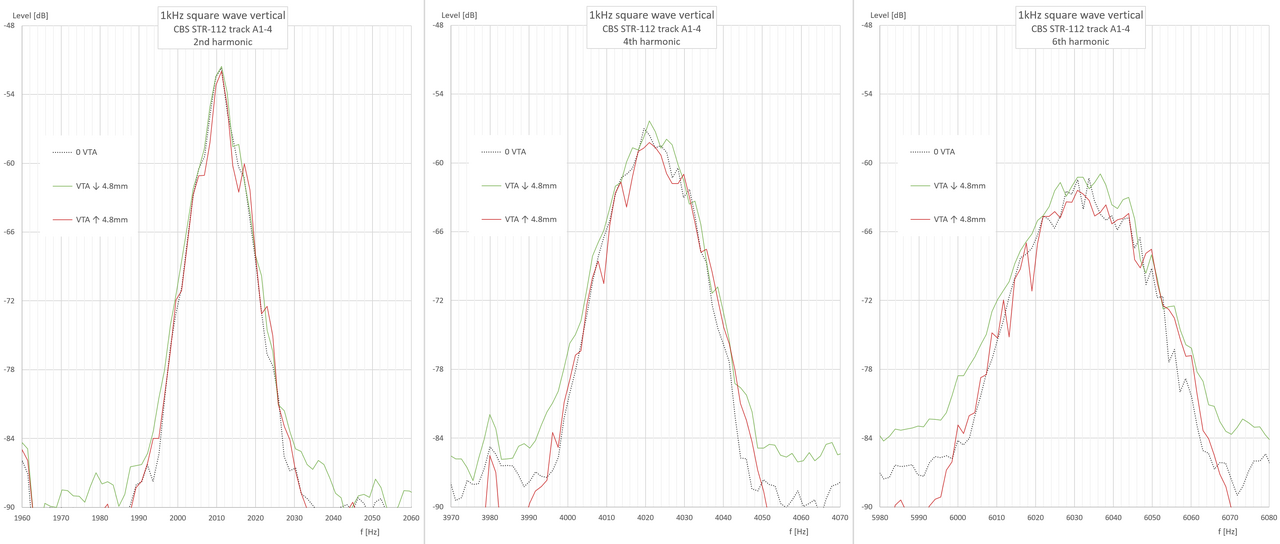

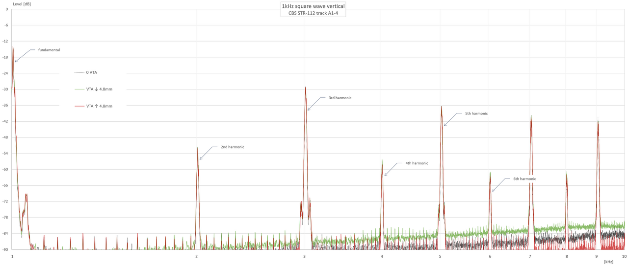

Study of 2nd harmonic of a vertically cut 1kHz square wave on track A1-4 of STR112. I measured with 0 VTA, -4.8mm VTA and +4.8mm VTA
FFT of the different settings of VTA:

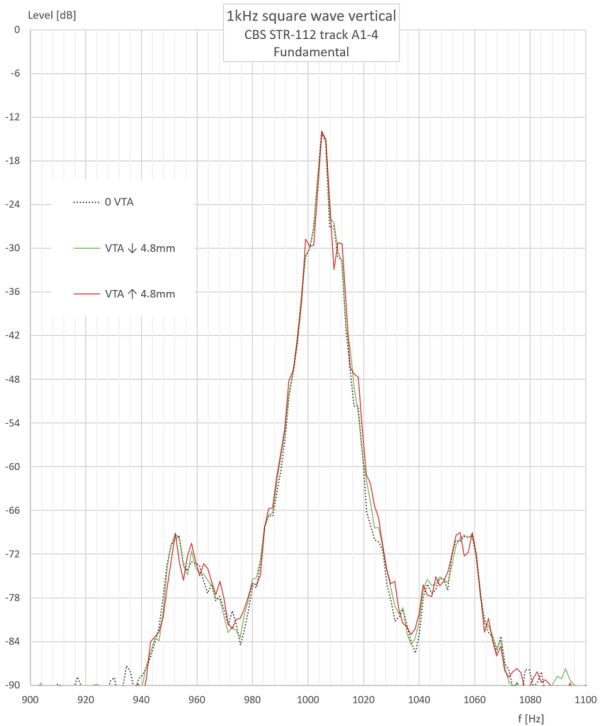

Closeup of fundamental:
Closeup of harmonics:

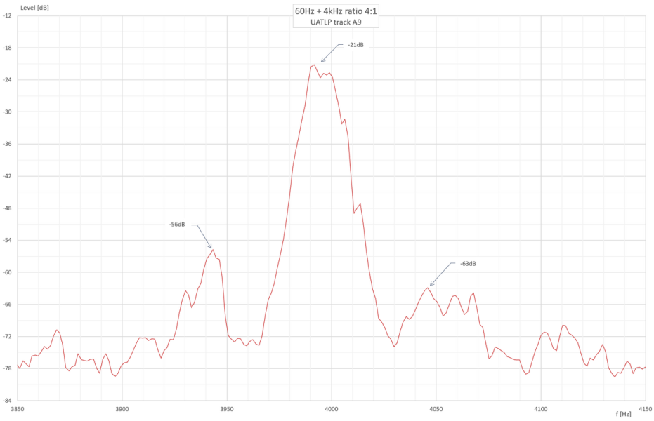

Study of the side lobes of 4kHz of the IMD track 60Hz + 4kHz 4:1 on track A9 of UATLP. I measured with 0 VTA, -4.8mm VTA and +4.8mm VTA
Sorry, I only have a screen shot of the FFT for the "0 VTA" setting:

I could not see any significant impact on the signal by changing the VTA quite substantially.
The different VTAs range about +/-1.5 degrees on an 11" arm. The changes are VERY visible by eye, but I think it's really not much in the groove even for a line contact stylus. I think 1.5 degrees error corresponds quite close to what is audible, about 0.7%THD.

If you are simply raising/lowering the tonearm, you are changing MANY things at once with the most easily audible changes coming from changes in multiple vector forces. This is particularly true for the Kuzma 4Point design. This means your results are - at least - measuring the changes of at least seven parameters at once and very likely well over 10 parameters. This is why I make such a point of changing SRA and VTA at the headshell.
You are probably aware of this but the difference we are most sensitive to is the time domain, not frequency domain. It has been shown on multiple studies that at higher frequencies we can hear timing differences in the low microsecond range. If you want to see how things change when VTA is changed in isolation of other variables you have to get into Fourier analysis to see the details AND have the ability to change VTA without changing SRA. IMD measurements won't tell you enough.
Also, VTA is sensitive really only to vertically modulated grooves so you'll need either an out of phase signal or at least a single channel signal (less sensitivity, however) to do this analysis. The tracks you are using are all horizontally modulated so you won't see the effect of VTA changes. SRA, yes. VTA, no.
By the way, as I've said in my videos and seminars, that CBS STR112 has 3.4 degrees of cutting zenith error. That alone is quite a lot to drown out some of what we want to measure into the noise floor.
You are totally correct that zenith ERROR (no such thing as "zenith" in vinyl setup) and azimuth are much more sensitive on a degree for degree basis. I highly doubt we could hear less than 1 degree of SRA or VTA correction (ISOLATED, of course), but 1 degree of zenith error is obvious and so is it the case for azimuth.
You can start to see how complex it is going to be for us to study SRA in isolation of all other variables. We are in the process of collecting the right equipment for it already.
Yes, I know. It is very difficult to isolate any of the parameters.
But my intention is to find a method that guides me in the right direction anyway.
I'm aware I still need to iterate among the parameters.

Two of the three tracks I show above are vertically modulated. Track A1-4 on STR112 is 1kHz square wave vertical, track B4 och UATLP is 1kHz sine vertical, and track A9 on UATLP is 60Hz+4kHz ratio 4:1 lateral.
I didn't know that. That's a big error.
I found quite big differences in the cuts between two copies of the UATLP also. Less than half of that, but that track was on a nullpoint (track A5).
