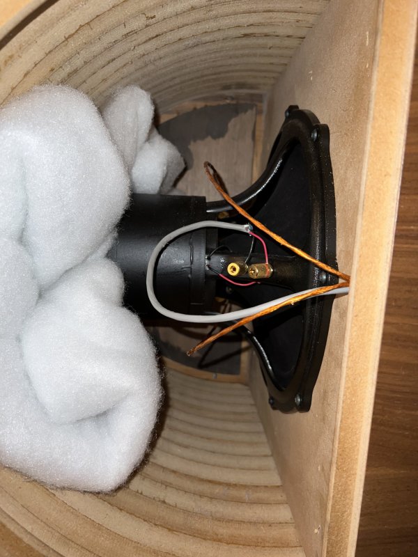

Yes! I finally found an expert to come to my media room and voice the speakers to design a proper passive crossover. What a difference it made! But the original crossover was never properly designed (as some here have pointed out), so I suppose it’s not a surprise that this new one is so good. It’s a 1st order for the midrange (RCA 1443 on a conical maple horn) and upper bass (Supravox EXC-2000 in a LaScala style folded horn) and 2nd order for the Tweeter (Fostex t500aMkII). The transmission line sub has its own active crossover.
We achieved response within 4 dB across the range from ~20 - 20k. And more importantly, it sounds great. I’m now getting Humble Homemade HiFi to rebuild the crossovers with the best components. The crossover engineer is a genius, but “doesn’t believe in” high-grade components.
One interesting thing is that stuffing the upper-bass cabinets with Dacron has smoothed out the response. I’m not sure not new to many of you, but I had never thought of it.
Sounds a great result. Love your choice of drivers and approach tbh. Even though I haven’t heard it, I can well envisage what you have. Enjoy Surge!
