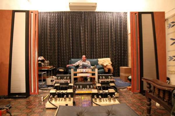

This is a photo taken by Thomas Schick of Schick tonearm when he visited a few years ago :)
Amazing stuff. You are the King, Kong.
I must say a couple of things though - I understand that placing close to side walls can reiforce the bass even more. I prefer panels such the triangle is right, if they are too wide w.r.t the triangle it feels like there is a hole in the middle of the stage.
VDH Colibri can be so explosive. That into FR is going to be mindblowing.
