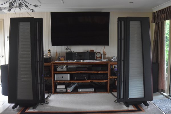

Tango
Mar 12, 2017
4,938
6,268
950
Bangkok
thazeldean
Mar 1, 2013
40
61
923
Hello Tang,
Graz delivered the speakers the night before last and it took until late to get them set up. We moved them further into the room than we had them originally. I am still coming to terms with the openness of the sound and the increase of treble energy.
The bass is a little light at the moment and I am still experimenting with position and amplification.
The crossover permits different amps to be hooked up to the bass and the MRTW but Graz is cautious about trying this option because of differences in output power levels of various amps for a given input.
I will get back to you when I have spent more time with the speakers and tried different arrangements.
Regards,
Tony
