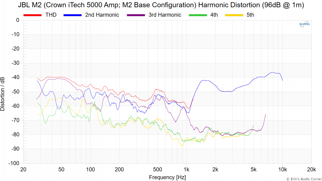

Ok, tell me which loudspeaker will produce 105 dB levels with 0%. distortion?None! Ok, which will produce the lowest distortion at 105 dB? That’s the Klipschorn and the La Scalas, which have distortion around 0.1% even at 100+ dB. Your garden variety 85 dB efficient moving coil, even the most expensive JBLs, Magicos, Wilson’s, all will produce 10 % distortion or worse at that sound level, particularly in the bass where most moving coil dynamic speakers perform very poorly. Check out the distortion curves of the ultra expensive JBL M2 even at 96 dB. The thing is going to pieces in the bass with distortion at -40dB. At 105 dB, it’s probably completely distorting. Goodbye, high fidelity.

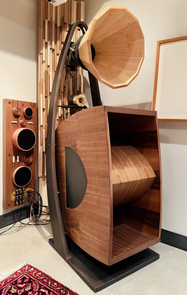

I guess you didn’t read my post or see the image of my speakers. You’re preaching to the choir ;)
I didn’t say anything about 85dB efficienct speakers. My horns are about 105dB effecient and 8W is the min., they won’t quite hit 105dB SPL with 8W.
