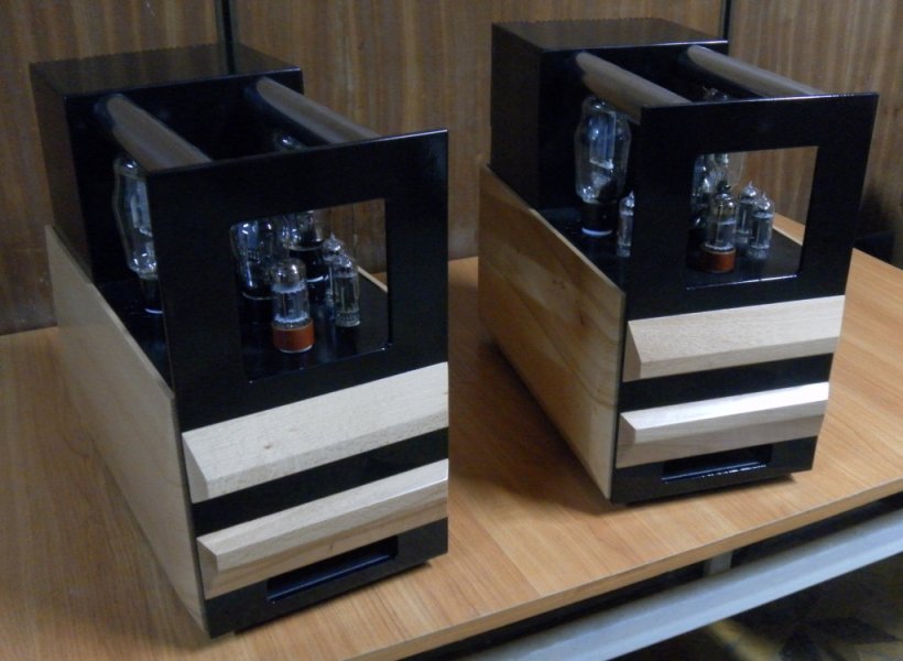

We can make an amplifier with a much better sound for 10% of this cost. For example, as in the photo.

In the photo, SE monoblocks on two 811A tubes with a power of 45 W each. 100W on the 845 isn't a big deal either. The problem will be that this amplifier will weigh about 100 kg, and the US post service accepts parcels weighing up to 20 kg from Ukraine.

How can an 811a make 45 watts of audio power when it’s max plate dissipation is 45 watts…not much more than a 300b. I think WAVAC used this tube and got around 15 watts output.

I might add to get around 45 watts of single ended power…from a single tube you need about 3x the dissipation of the 811…like a GM70, which has 125 watts max dissipation vs. 45 watts for the 811a. Did you by chance mean two 811as in parallel to make 45 watts? I still find that hard to believe…
