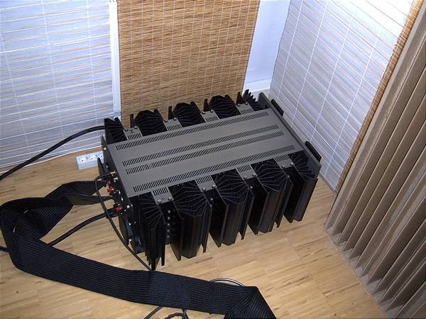

My 4 KMA-160s would heat the listening room when idling. Not kidding. Krell's new amplifiers are advertised as using a sliding bias technique, but not sure about the older ones. Note the heat fins on these 160s from a net photo I found:
Lee
That sliding bias system has been around since sometime in the 90s.
Krell has also used sliding bias designs in some of their previous amplifiers. However they claim that their latest amps use a newly developed bias system that monitors and actively changes the output device's bias in real time to maintain class A operation. I believe that their previous designs tracked the input signal and then adjusted the output stage bias accordingly. We'll have to wait until they are available for audition to determine just how successful their new designs are.
