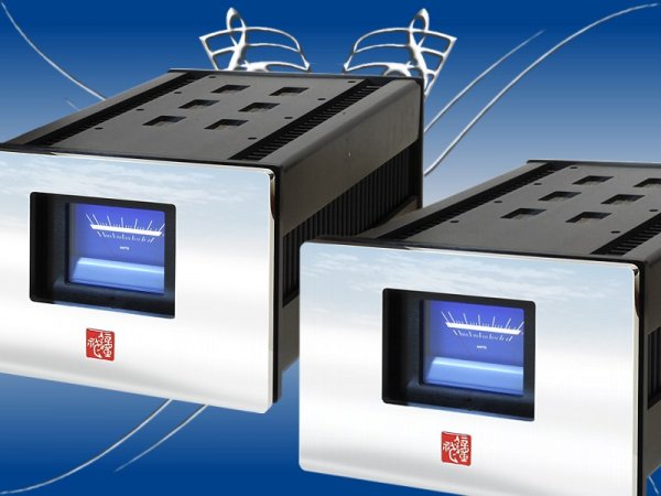

According to the Wavac site the HE 833 is pure class A all the way to 150 wpc

Hi Pradeep, yes I have heard this...and in fact, ii nearly considered them when I was looking for an all-out assault tube amp. After a year of searching...I ended up with Gryphon SS Class A...and have never looked back.
