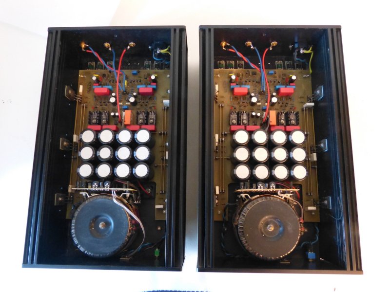

This omtec class a mono amps 25 watt sounds phantastic with horns.why?
i have never seen an amplifier that had such good measurements sounded so nice and was completely free of artifacts in the sound. with the high sensitivity of horns they bring all the noise to light this amplifier makes none. my tip used get a couple for 1000 €.

Have you actually tried them on horns?
No, today I only have tubes in the signal path, for me a more emotional sound. except for active bass, I just use transistor amps for more control. Knowing the Omtec with Klipsch, Acapella and Avantgarde horns was a very clean, silky tone, nothing sounded unnatural. definitely give it a listen they are not very expensive and can keep up with all the big names.a real alternative if you don't want tubes.
