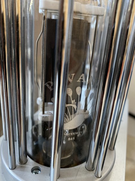

my first post here. I recently bought a pair of VPAs that came with PSVANE (don’t know witch model) but not Nagra branded. I good friend of mine, who is about to acquire a couple of VPSs for himself, just sent me a picture of the Nagra branded 845s that come with the amps he’s getting and the interior structure of the Nagra branded 845 is way more robust that’s the PSVANEs I own. They thickness of the vertical metal structure looks like the one used by the legendary Amperex 845. I’m attaching both pics for you to see.
I just mailed Nagra so they can confirm that the Nagra branded tubes are still made with this internal construction. Do you think this could make a big difference in sound? Any experiences with with will be appreciated.

Hi all,

Not sure if anyone answered your question. So here goes, The tubes with the larger metal structure are Shuguang. There's various grades of these, but they are all mid tier. The other PSvane tube is a splinter of Shuguang dedicated to making "top tier" tubes at premium prices. Point is, there's alot more to the sound quality than the mass of the grid frame; though the frames strength (and design) does help reduce shipping failures caused by trauma. Plate, grid materials and (crucially) tolerances all play a significant part in sound reproductive quality.
So to tolerances... The PSvane tube you have will almost certainly be better than the Shuguang tube out of the factory. This is because PSvane will pay more attention to materials and tolerances than Shuguang - it is a more costly tube of course. However, NAGRA will take a modest factory tube like the Shuguang because it's readily available, not too expensive, and subject it to various additional tests design to assess its tolerances both electrical and physical. As a result they disgard a huge quantity of those tubes that passed the factory QC, but are insufficient or out of tolerance for a Nagra branded deployment. The Nagra vetted tube, in my experience tends to sound better than any of the comparisons I have done to date. This suggests that QC (i.e. tolerances) have a huge part to play in sound reproductive quality and longevity. That said, there are a new crop of very high end tubes emanating from China including bolted metal plate (as opposed to mounted graphite) reputedly manufactured to higher tolerances. I have not tried these tubes as yet. Separately, Elrog, a German based manufacturer of tubes using the latest CAD processes has released a series of tube built using 2020 standards of engineering and science. These are reputedly very good, but their 845 will not physically fit into a Nagra VPA... All the best and hope that helps.
