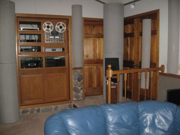

ASC Tube traps
I agree using ASC tube traps, but I took the advice from Peter Moncrieff of IAR. Using his
methods and my own experience, the acoustics of my room are exemplary. All of the
aspects of good sound (imaging, sound-stage, bass that is tight and well controlled,
and voice reproduction are what I was seeking, also transparency is outstanding.
