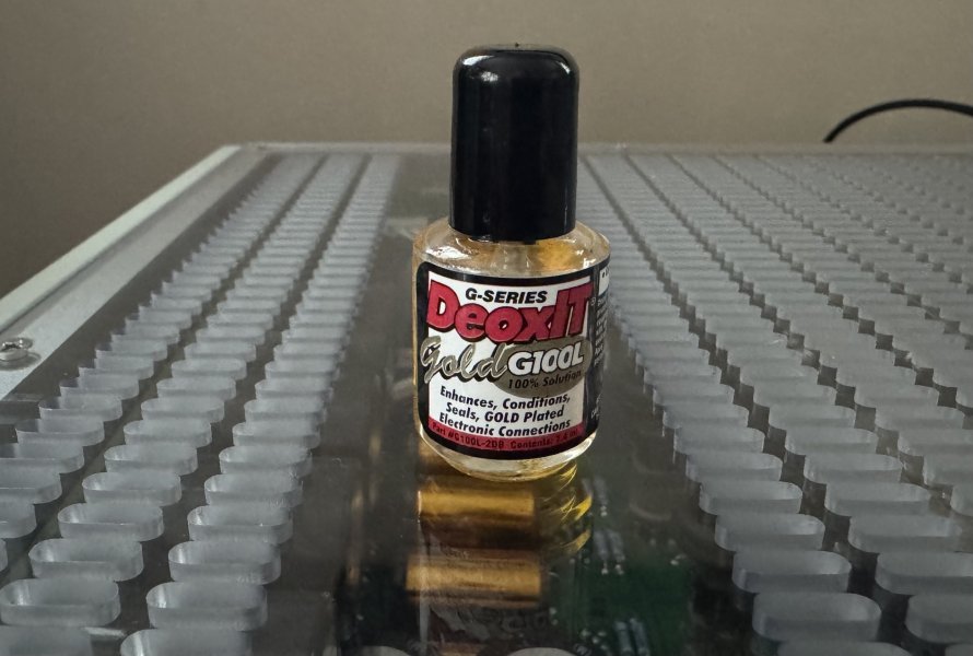

Went through the whole system to clean connections today (see photo above) and it definitely added some clarity and the bass seemed a little bit better as well. Love the G100 stuff.

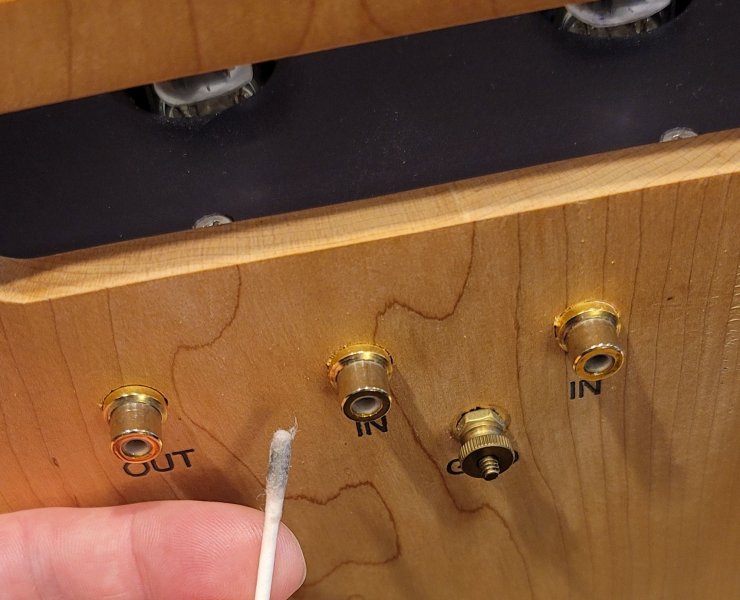

This is why it's important to clean your connectors! Caig D100L removed this stuff from the RCAs of a used phonostage I recently purchased. Multiple applications were necessary. It just kept removing and removing crud. After no additional oxidation is removed by subsequent applications, I usually clean the D100L off with 99% IPA and follow up with an application of Caig G100L to minimize the formation of new oxidation. Most, if not all, RCA connectors that I've ever cleaned are about this dirty.
