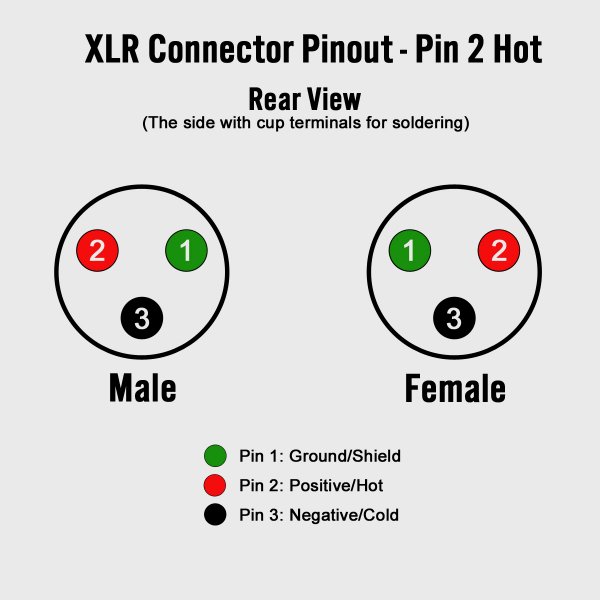

OK this one is new to me, thanks a lot. So I double the center pin (signal). Do you have diagram for the XLR pinout so I know which pin goes where?

Xlr standard earthfree...did youwant that?
No problem paste after soldering clean it with a brush&alcohol
