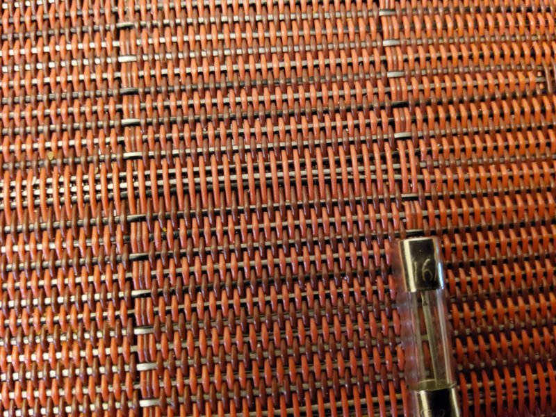

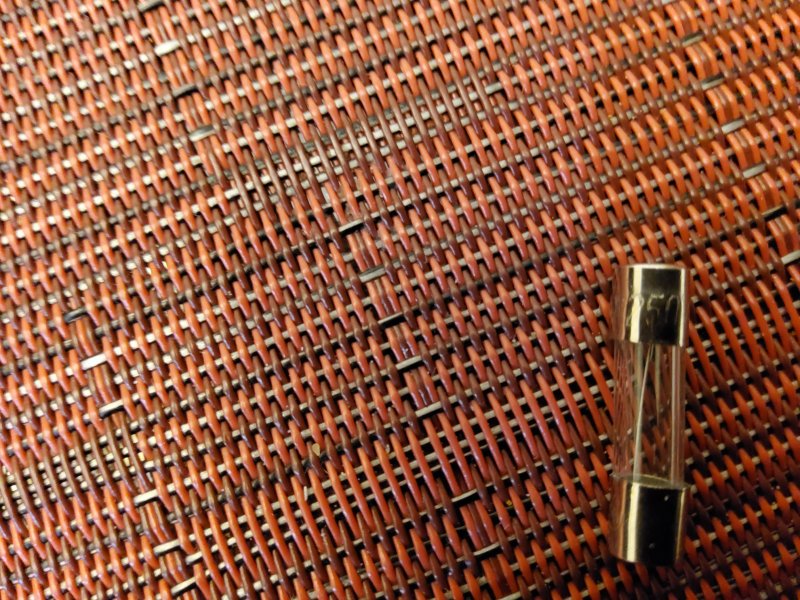

Hi Kal, I took a few more upclose photos. I think they show 16 amp? And there seems to be a space between the 1 and 250. Let me know what you think. Thanks so much for your help. Regards, James

Unfortunately, the fuse on the ac side doesn't tell too much of a tale with these Chinese power supplies at
their rated current output on the delivery side.
I highly doubt you'll get 7a continuous out of that PS. You would need some serious iron in an LPS for that. There are ways to test for it but it doesn't sound that you have the equipment to do so nor the knowledge.
Plug it in and see what happens. The worst you can do is blow the fuse.
There are dozens of variants of those supplies on aliexpress and ebay... all of them look like they come out of the same factory in China.
Thank you! Much appreciated.
