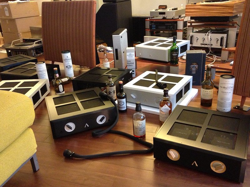

Yes, this time the smoke came out from the main unit, apparently one of the caps in there blew! At the time, all the tubes in the PS were stock, but the 12ax7 in the first 2 gain stages (ie 8 tubes) were Tele, and the 6SN7 were Ken Rad.
I bought it not long after they introduced the Eclipse version, so may be around 2012 or so !
Actually, our group bought 3 units at the same time, and had a party! Happy time before all 3 units went bad within 40 hours of operation :p Apparently, Aesthetix got a bad batch of caps then!
View attachment 143425View attachment 143426
Cool pictures ! :)
Are you sure that there was no user error involved , due to high levels of Whiskey in the blood stream ;0}

Is that the Frank Sinatra limited I see in the background? I have a few bottles of that. IMG_6704.jpeg
