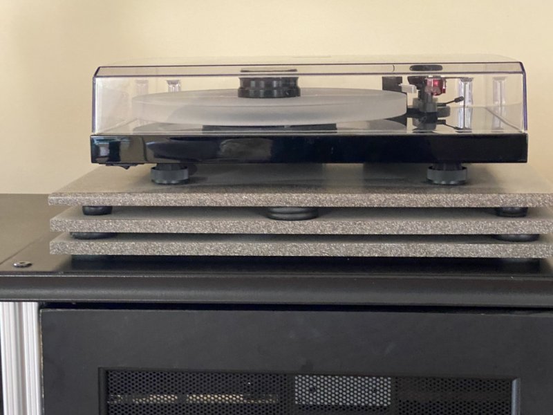

Both Sorbothane and Herbie's Audio Lab silicone based damping material have worked very well for me when used between boards that don't pass resonance (Corian, Acrylic) to create relatively inexpensive, sonically neutral isolation platforms. Note that I have never found Sorbothane to work well when used directly on a component - it always muffles/muddies the sound. In the photo below two 1/2" thick Corian boards with Herbie's Audio Lab damping discs between them provide very effective and relatively inexpensive isolation from the floor. The Marigo Mystery Feet between the amp and platform do a superb job of "draining" airborne and internally generated resonances. In the 2nd photo a DIY Corian/Sorbothane isolation platform for the entry level turntable in my 2nd system eliminated footfall issues that three different commercial platforms I tried failed to isolate it from.
