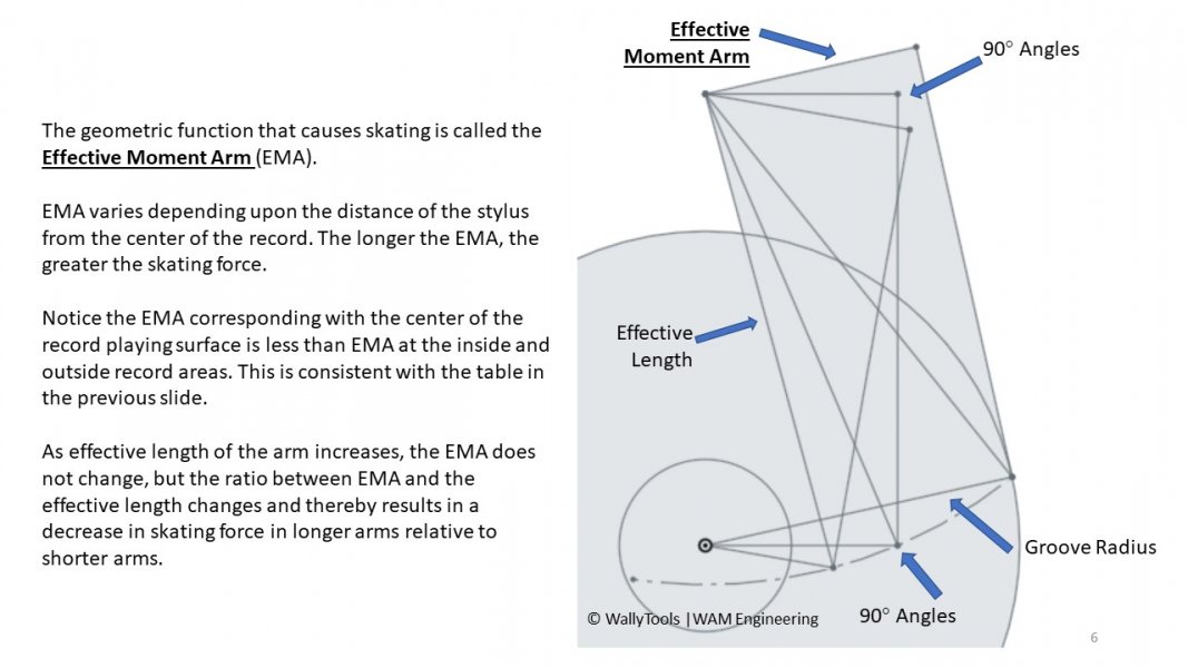

There have been many commonly held beliefs about anti-skating force that have popped up in this thread. Many of those same beliefs are held by some tonearm and cartridge designers and some audio journalists. Unfortunately, many of them are simply not true. I'll cover a few of them here, but first a primer:
SKATING FORCE IS A FUNCTION OF TWO ELEMENTS - FRICTION AND EFFECTIVE MOMENT ARM (EMA)
I'm sure everyone understands friction, so what is EMA? I went over this in an attachment on one of my past website blog articles but below is the relevant slide. Just think about having to draw a three line segment series with each joint at 90 degrees. It is important to start the drawing series with the starting point at the spindle and drawn to stylus location. The second line in the series runs from the stylus to a point where the line will be at 90 degrees to a line drawn to the pivot point of the arm. (This second line will also happen to be the SAME length as the effective length of the tonearm.) The last line segment completes the journey to the arm's pivot point. Remember, each join angle must be 90 degrees.
As long as the third segment (the Effective Moment Arm) in that series EXISTS in the drawing there will be a skating force. The longer the EMA, the greater the skating force. In the drawing below you can see how the EMA is longest with the stylus at the outer area of the record followed by a decrease and then increases again at the inner area of the record. If you were to draw this line segment sequence for a tangential bearing arm, you'd see there was no third line - and therefore, no skating force.
MYTH #1: Longer arms do not have skating force
As you can see from above, EMA does not decrease when moving to a longer tonearm but skating does decrease in longer arms because the ratio between EMA and effective length changes. Since 12" arms are about 30% longer than 9" arms, does that mean that skating force decreases by 30% for 12" arms? NO! This is because friction remains independent from arm length and friction is the second element required to have a skating force develop. It takes a more sophisticated logarithm to calculate the true decrease in skating force when moving to a longer arm. I won't touch that one now, but suffice it to say the decrease in skating force is nowhere near 30% less skating force when moving to a 12" arm.
