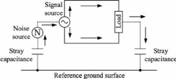

looking at the diagram I have a question is this purely in the signal path only ?
Al, this is one of several pics I found that depict a ground loop as somehow involving capacitance leakage to ground. As far the accuracy of this image as a proper depiction, that is above my pay grade so I can't answer meaningfully.

Ok sorry I read further and thought I fixed my post. It’s seems it’s a balanced iso transformer. This is a good unit
And can made better by an isolation of the grounding of the unit. A bal iso means it’s 230 volt in and 120 volt out it’s done with two 60 volt windings on the secondary. this helps dc offset and common mode noise. Add a simple high freq tank circuit and iso the ground and it’s top shelf power. Only a well made re hen could better it in specs.
