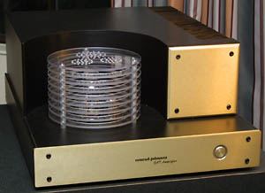

Hi Brian,
Have you ever seen the post below from a number of years ago...does the brief description of the design mean anything to you? Was just curious given discussions here about power and SET.
http://www.audioaficionado.org/showthread.php?t=9814&page=12
"turntable turntable is online now
Senior Member
Join Date: May 2009
Location: Downunder in Sydney
Posts: 1,752
Default
Remember this from CES 2003. Apparently cj have enough parts to make several pairs.
conrad-johnson GAT Amplifier ($38,000) is the company's first venture into 300B tube amplification. This is the only 300B amplifier that outputs 1,000 watts (not a typo). A low ratio transformer is coupled to a push-pull buffer. This keeps the voltage gain characteristics of a 300B but the current gain of the output buffer stage."
