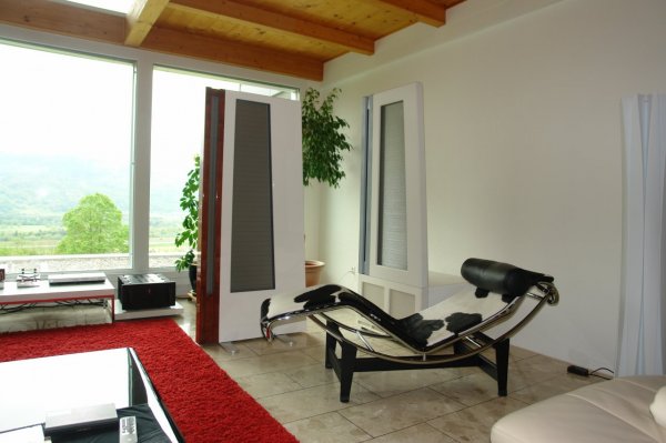

Carl, no go on Divas or FRs.
My eaves sweep down from a central apex of 3m.
At the point where the spkrs sit, the eaves would impose on anything in excess of 1.8m.

Hmm, guess that is lower in height than I thought from the pictures of the room. I think I would rather have a Duetta with tubes on the midrange driver, hybrid SS on bass panel, and the added supertweeter over Scintilla.

Actually my descending eaves have added a lot to acoustic calm.
But indeed, they preclude spkrs higher than Duettas or Scintillas.
