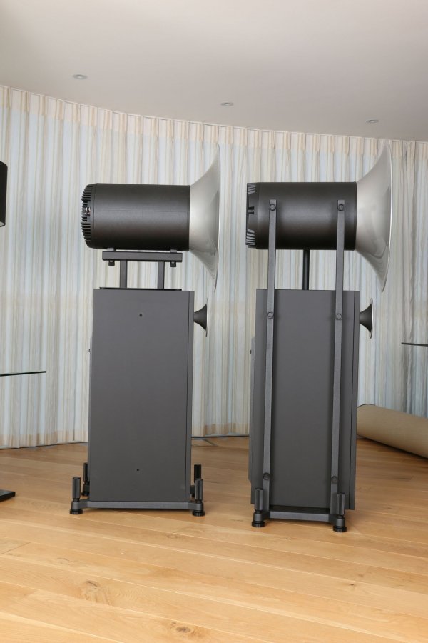

So it appears that the new Duos have adopted the Uno style in that the mid and top drive units are both installed within the main enclosure. This reduces the brand's distinctive and somewhat quirky looks, but it probably does allow sound quality improvements, even without the new amplification technology.
The existing Duo XD has an unfortunate constructional feature in that the horns are a little higher than ideal. Setup guidelines say that the top surface of the main enclosure should just be visible from the seating position and tilting forwards may be needed to achieve this. Unfortunately, over the years since the tweeter was incorporated into the main enclosure with the mid-horn above (ie the Grosso) , the main enclosure has been lifted by the introduction of the new fancy spikes, and the new base frame and the fact that the enclosure now hovers above this frame. All these things have resulted in the increased height of the sound sources - 2-3" higher than the Grosso from which the current Duo has evolved.
I have saved some height with my own mods to the Duo XD by ditching the "scaffolding" and I'm pleased to see that AG has at last removed these upright supports from their new Duos. I look forward to listening to the new Duos, though I suspect there will be a big hike in price. Peter
