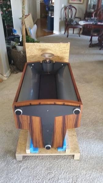

My 2014 Duo Mezzos only have adjustable crossover and volume to blend in the basshorn with the mid range horn. It is a fantastic speaker and really solved the bass integration issues of my Duo Omegas with 2x10 subs, but did require four corner ASC Tube traps to clean up the bass energy causing one note bass. I would assume the later XD version would not require the bass traps.
I have not heard the Trio's with Basshorns- either pre or current XD. My room is 15 by 23" and not really big enough for Trio's, so I've not a made a point to try and audition them.
The major downside of Duo Mezzos is the foot print is about twice the size of standard Duos, they weigh quite a bit more and they require custom crates for shipping due to the unique dimensions of the Basshorn.

Midbass horn would be a better description. I think bass is a bit disingenuous as it has no effect on actual bass frequencies. It's purpose is clearly to make the crossover point more horn like.

The Basshorns runs 23hz to 140 hz, so seems to me it does impact the Bass, but yes, it does integrate better in the 140hz mid bass range with the horn midrange horn than a conventional subwoofer in the box.

I doubt there will be any horn loading with that horn below max 70hz.
The crossover is at 170hz according to AG. The bass may play to 23hz but that doesn't mean the horn has any effect on it whatsoever. In fact I bet the horn size is approximately 20 inches (including face) because that'll make it horn load exactly at the crossover, and hence provide horn sound at all crossover points. This is based on the fact that at 170hz you need 19.5 inches of horn to effect that frequency as a horn (170hz is 78 inches long, and to horn load you need 1/4 of that). The declining horn effect below the crossover frequency will transition nicely to the sub effect. And hence, it's really a midbass horn on the drivers that play sub to midbass.
I'm being technical. It's a beautiful speaker. I'd like to hear it sometime.
Folsom and Audiophile Bill - I'm sure you guys are correct about the horn loading below 70hz.
The width at the mouth of the horn where it turns flat is about 20". The inner width of the horn cabinet is 22".
So it's not a true Bass horn, in the sense of the giant monsters with a compression driver that take up a whole room.
Basshorn is simply AVs name for these as opposed to their 2x10 and 2x12 subs that are not horn loaded.
