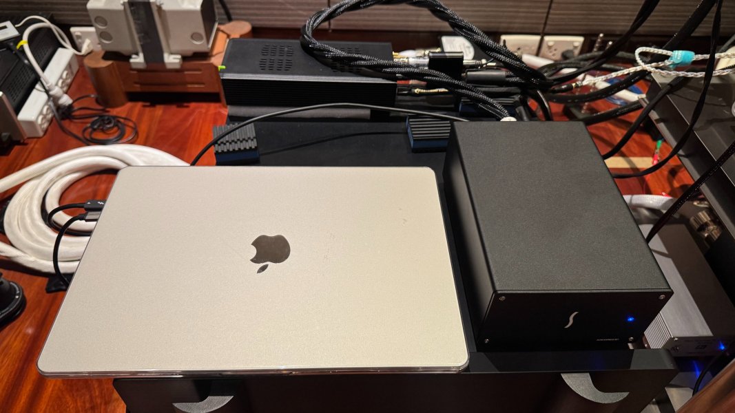

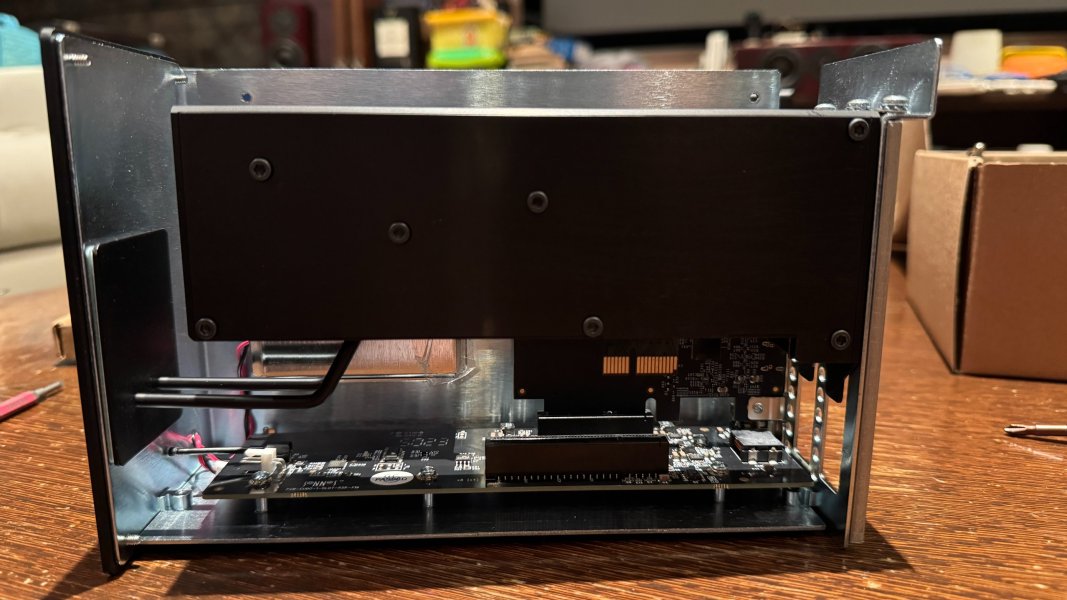

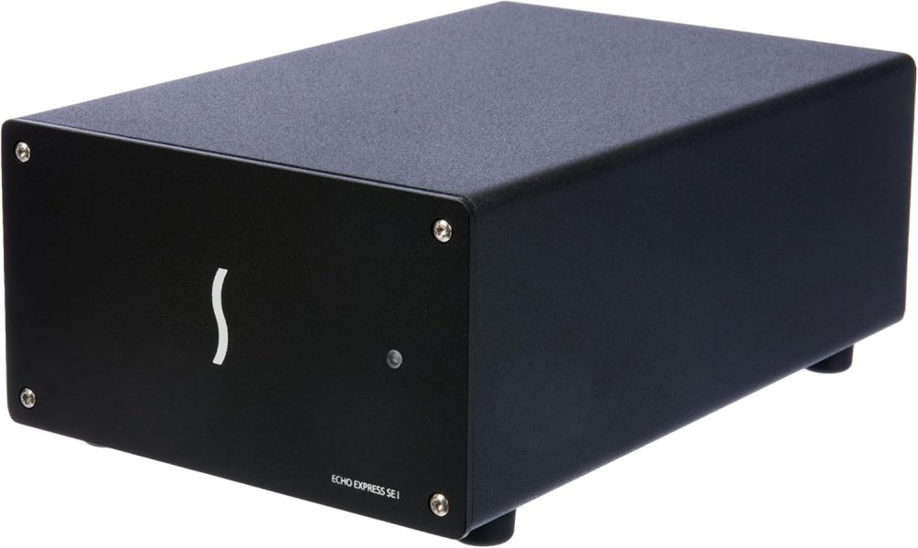

It’s been a week since I got my parts to adapt my Pink Faun Ultra USB card/bridge into the Sonnet Echo Express SE1 Thunderbolt3 Expansion Chassis (Echo-EXP-SE!-T3) - phew, what a long name! :rolleyes:
Glad to report it fits and works as expected. This Sonnet box accepts a USB C Thunderbolt connection from my Macbook and offers a PCIe extension slot. With a short extension cable and some supports, I managed to just fit the Ultra bridge inside in a sturdy way with very little space to spare.
The Ultra bridge is externally powered as is the Sonnet box. Both from my Paul Hynes DR7t+ supply at 5v and 12v respectively. But a bit of history before I get to the sound. The exploratory path I took to get here. I am repeating some of the info I posted earlier but it's mainly for my own reference and makes it easier to read.
Until recently, I was playing the Bacch output directly from my Macbook into the DAC using a Roon core in the Mac. This method allows one to hear the effect of the Bacch filters but it is as low end as it gets as far as hardware is concerned and this is reflected in the sound quality - an average sound with a lack of dynamics and blur focusing. Pretty acceptable, given the startlingly wide Bacch soundstage, for many new Bacch users on trial to see what all the Bacch hubbub was all about. But I wanted to see if the quality of the sound could be improved while keeping the enormous Bacch soundstage.
First I tried putting the USB output of the Mac through a series of USB signal cleaning filters that I have good experience with many years ago when I first experimented with digital cleaning. The Uptone IsoRegen followed by the SOtM tx-USBUltra. Both do a good job of cleaning the USB signal a touch but the tx-USBUltra has the added advantage of adding an external Reference Clock which I added my unused Cybershaft OP-14 so I used this as the end point before the DAC and wrote about it earlier here and here. Both devices powered at 9V by the PH DR7t+.
Immediately the effect was a better sound, the image tightened up considerably and there was a wider difference between the quiet passages and the loud ones. This proved to me that the Bacch filtered USB signal from the Mac could be improved and it was worth perusing towards my ultimate goal - passing the signal into an audiophile sound bridge and using that as the last signal generation before the DAC. Especially so if this bridge had a good clock.
So next was to try the PCIe extension box mentioned above. I have a few USB sound cards on hand and I initially started with the Pink Faun USB v2. An unusual card with a clocking frequency at 40MHz instead of the standard 20MHz. The card work almost immediately and it sounded good but not at the level I had expected it to. Perhaps the Sonnet box and cabling was still breaking in? Or perhaps the v2 card had been resting for over a year? I tried passing the output USB signal into my USB cleaning setup and then the sound settled nicely. A good step up, more clarity, better soundstage placement than just the cleaning setup. Bacch soundstage is already second to none but with that additional clarity and solid image placements, it’s something to behold. Very nice.
Why not go straightaway into the Ultra card/bridge? Because it didn’t fit. This bridge is designed specifically for the Pink Faun’s Ultra streamer and only this streamer. The shape doesn’t allow it to be adjusted to fit other streamer/computer slots. So I used a 5cm ADT Link PCle riser extension cable R11SF and some supports to make it work. The Sonnet has an in built fan which I felt was unnecessary so I disconnected it to reduce electrical disturbance but left the LED light on.
The final physical setup was done but the device wasn’t recognised by the Mac. After some trial and error tests I found that the Macbook had to be disconnected from the Sonnet box for a few hours and then reconnected for it to be recognised for the first time. Thereafter it's fine. An unusual requirement, different from the v2 card which connected without issues.
