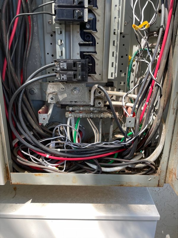

Aluminum is the devil when it comes to audio. Here is a typical example I see quite often. This is an outdoor main disconnect to a northern California home. Look at this neutral bar. I believe a part of why its so bad is the copper stand off holding the small termination ground bars. The copper and aluminum are reacting with each other. The utility neutral is landing on the left in the single lug. I guarantee that lug has oxidation between it and the plate. The plate is then bolted to another plate that holds lugs and small terminal bars. Those contacts are rotten. This neutral will be broken apart, a red pad to remove loose debris, then deoxit before reassembling. If deoxit had been used when the panel was installed, I am confident the amount of corrosion would be significantly less. If non at all. I use it on all my copper panels. I tear all my panels down, polish, damp with polymers, deoxit then reassemble and torque.
If you look at this panel, top left, you can see its fed by bus bars over the top, then into a split bus configuration. This is actually a pretty decent panel to work with. Those 2 open blades across from the 100A breaker, those have no CB main in front of them. They are live from the meter. Dangerous, but less connections/CB between your audio panel and the utility transformer. The bus on top is also copper. After it jumps through the 200A main to below, the lower bus is aluminum. Guess where this guys Subpanel CB will be landed.
I also guarantee you the bus from the meter to the main is corroded. I wish I could open the meter section and clean in there. It would have a profound impact on the equipment. I may have the electrician call the utility to break the seal, open it, spray it down, then close it. Some utility will let you do that, some won't.

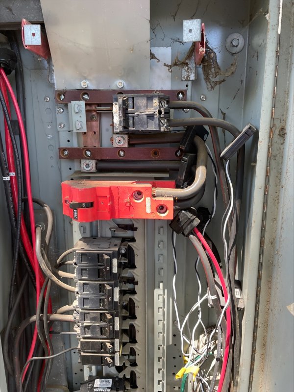

If you have a dirty surface such as the one above, Deoxit makes a polish. Its not really necessary. It makes it look pretty. I am more about functionality. I would use the D series in a spray. You still want to break apart contact surfaces to allow the product to really penetrate between the mated materials. You could use the polish between the mated material but its not really helping. A green pad might drag out some of the grime. Spray the G series over the top, wipe it off, then reattach the lugs or bars.
FWIW, the wire I noted in the image is not the feed. The feed is a bar through the side. I am going to move that wire and have a new 3 barrel lug installed for all things audio.

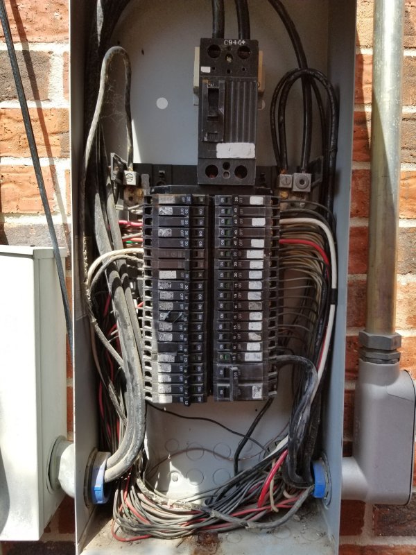

I think I showed this in another thread. This is a pretty crusty services. Look at the lugs at the top of the service. This was put into service in the 80s and is almost ready to be thrown away. Its getting near failure. Once the metal is gone, its gone. Treating it does not bring it back. I have all these contacts sprayed with the DN5S-2N. I use the non flamible, non drip. Don't use the regular D series in a panel. It is possible a spark could ignite the carrier propellant and start a fire. Once the carrier has evaporated, the remaining solution is the same.
You can spray every wire terminal on every breaker. And every termination on the ground and neutral. I may do a video one day. You don't want to go overboard. A tiny amount at each contact is all you need. You don't want a dripping mess. Wipe away excess.
